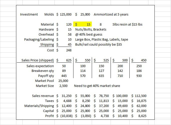

Vacuum is the only way to go if someone wants to tackle it.  The OEMs are no longer protected which is why I ran this past several suppliers whom I've worked with over the years.  PS - there is a reason why Maiers are not as wide as Honda OEM.  That was one way to avoid being sued.  I have 2 perfect sets of OEMs minus some light spider webbing.  They could be copied very easily.  Over $100k to get high quality OEM fender tooling.  Could source from China but it would still be $50-70.  Could go with aluminum tooling both not sure how many runs we'd get before the tooling is shot (probably enough to pay off the tooling).  The capital would be very hard to get financed being that the product is essentially obsolete and the demand is impossible verify especially with 250R/Hybrids limited in competitive racing.  Thus, vacuum is the only reasonable way to go (in my opinion) unless someone has the cash or access to a 100 ton press and a tool & die shop.  The plastic formula is the easy part but figuring out the cure time and temp will take some time and money.  I did a full workup on the fender sets with a couple different suppliers (USA Made).  The best thing that could happen is to get Maier to purchase the FB molds and let Laker go out of business.  I hate to sound ruthless but there isn't enough demand (committed buyers) to invest in the tooling and compete/pay it off.  Personally, I think we should hammer Maier with emails asking them to buy out FB design/molds.  Yes, the cost model would need fine tuned some (finance guys)...but these are averages from three contacts who have been doing this for 30 plus years.  I've been in Supply Chain for twenty years now and have been involved in many many new products being developed and feel comfortable with this analysis...

Someone has been doing their homework. Great job Bneau. Hope it works out for you. I love to see new adventurous projects based off of Passion.

I can't get enough preorders (i.e Smart Carb) to make it worth while and don't have a $100K to invest.  I would jump on the Brett bandwagon in a heartbeat though.  I do have a China contact looking at this....but everyone seems to want USA (i get it).  However, R's were made in Japan!  I gave up talking to FB and have been focused on getting Maier to make contact with them.  Ideally, I'd love for Maier to offer the FB fronts/rears and call it a race series.  They have come a long way....
