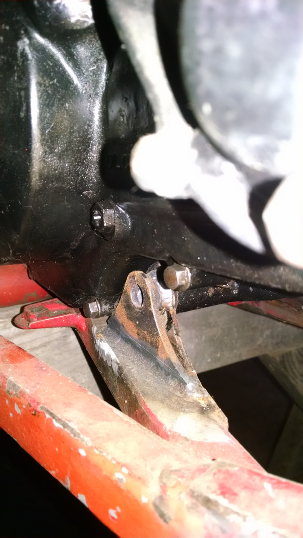

I had them welded in next to the original mounts, I did not understand that the old mounts are to be removed? Guess thats why my bolts do not fit lol. I will take a picture here and post it. Thanks for the help, the gusset kit really helped out big time!

here is a picture of the mounts, was I supposed to remove and or bend the factory mount over?

The replacement motor mounts are not gussets. If you put them on the outside you may be able to run a longer bolt. If welded on the inside the motor will not fit. One of the motor mount bolts are  a hair longer. I have them If you need one.Part# 96400-1014000

Yes please I can use it. I did weld them on the outside, the engine fits in the frame right now. Can I purchase it on your site by chance? Thanks for the help!

thanks. i will leave as is a use a longer bolt.
