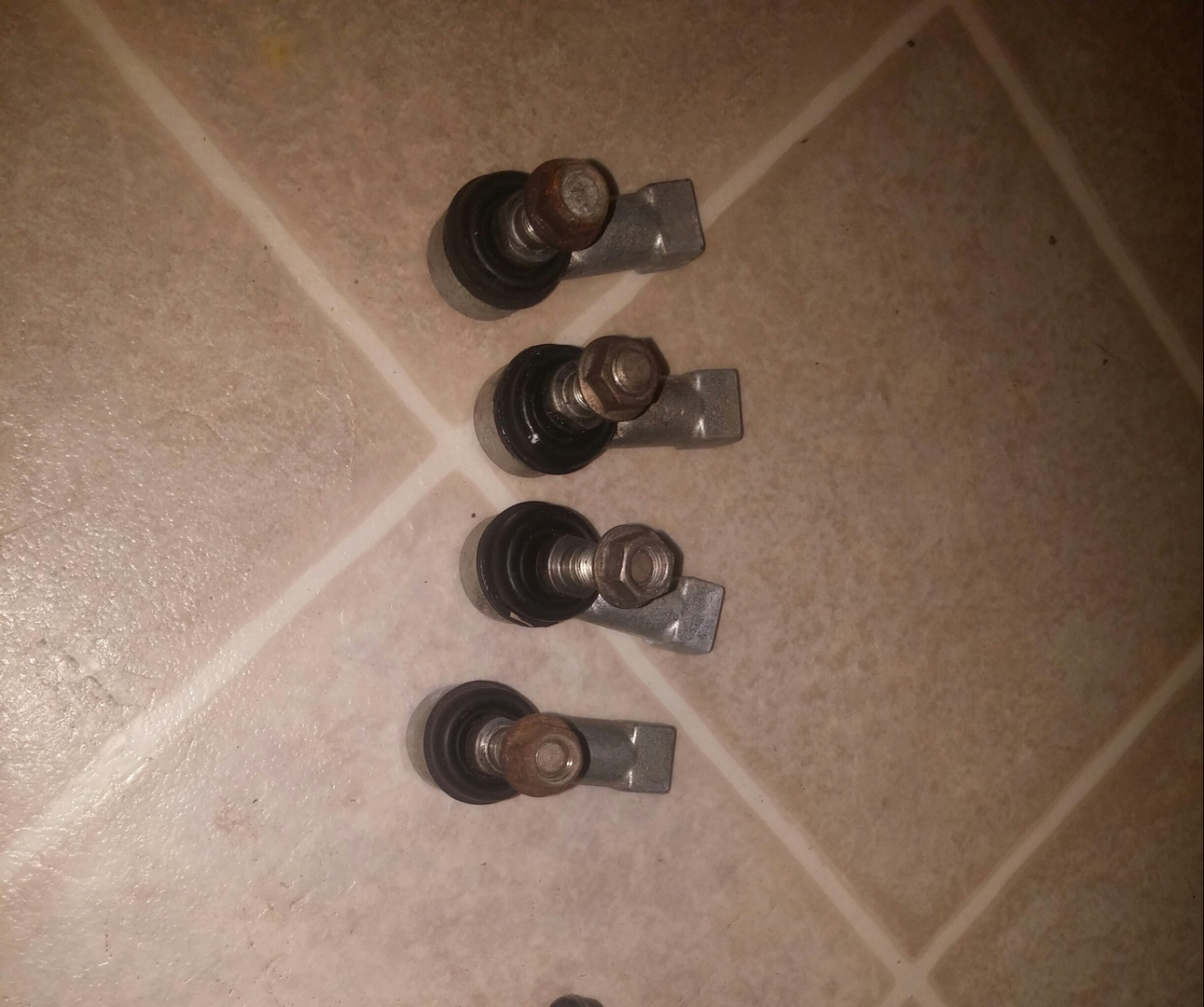

Looking for a good working coedition petcock. My R won't hardly run on reserve. Replaced fuel lines and found petcock leaking.
