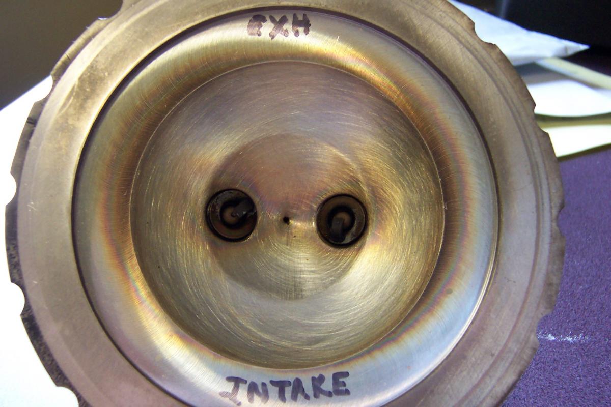

« Reply #14 on: August 24, 2013, 12:56:13 PM »
here  is my dome with dual plugs, this was after a 101 dyno pulls, the small hole in the center is for the compression release
