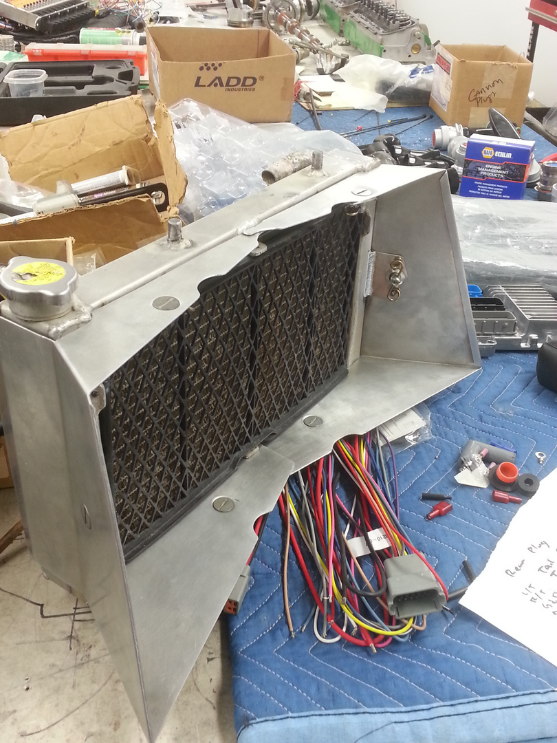

Sorry I haven't checked in awhile ill update it. This bike didn't get my normal attention as it was a very budget minded project but its nearly finished.  I still did a ton of work just no p.c. being that it was nearly mint. Ill re up when I'm on a normal p.c. but for now I just finished a set of shrouds. The radiator was about 2in wider then stock so the prm shrouds with spacers wasn't my thing.

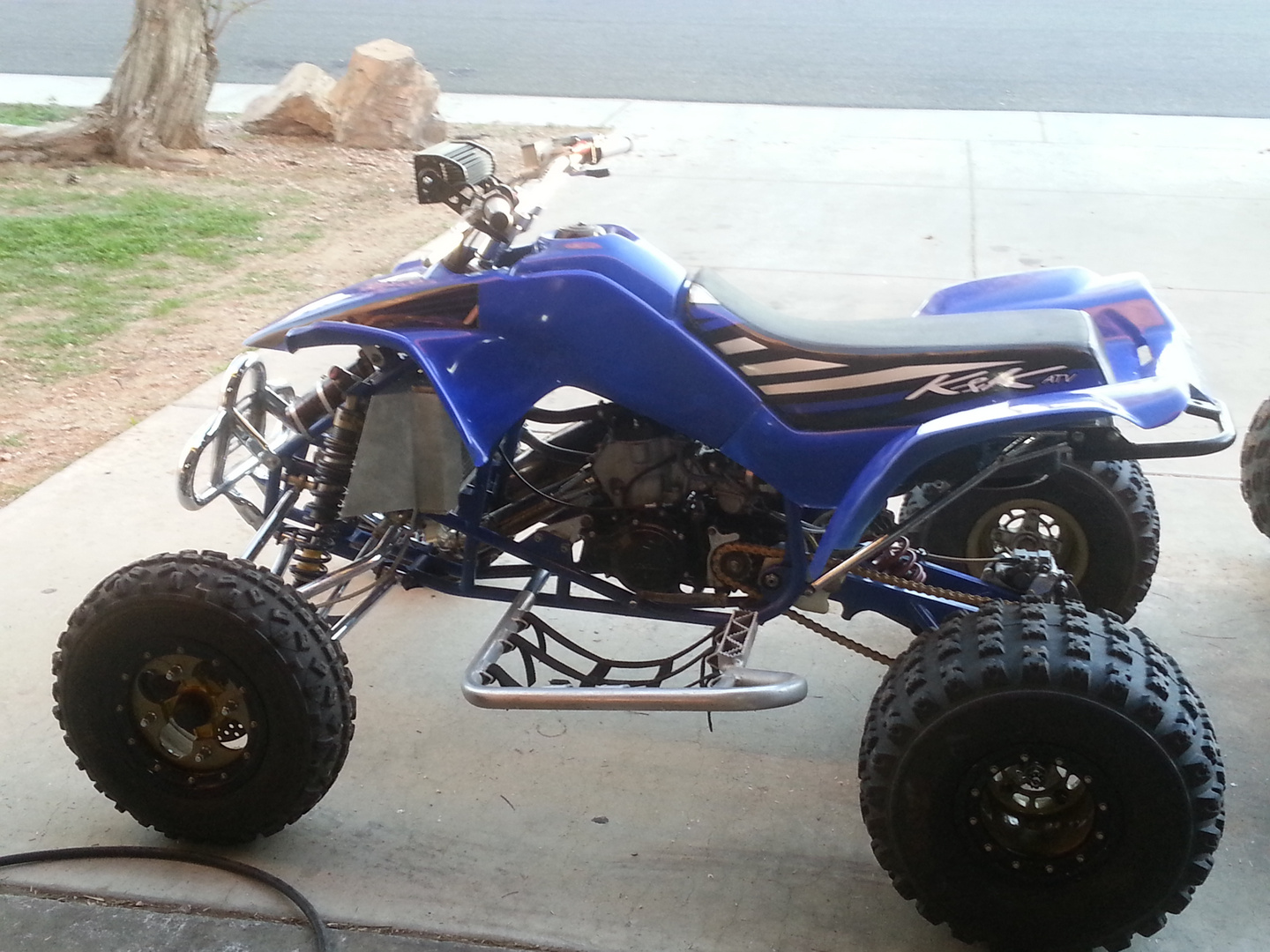

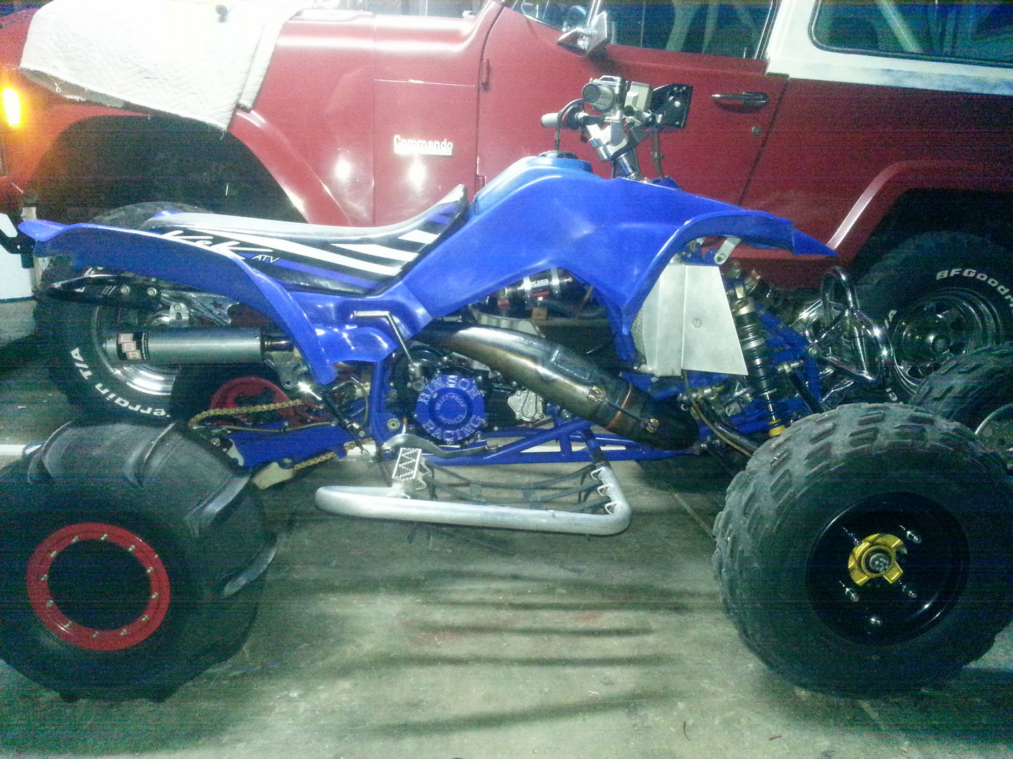

I haven't done much I ditched, the esr 9 pipe went to a 03 paul turner race. Put in a high compression dome, went to a 38a/s instead of 39 pwk.  Ive spent alot of time working out tuning and it runs pretty strong now. Had a good weekend at glamis a couple weeks ago. Season is almost over here so maybe ill do more over summer but I doubt it. Its not flashy but its a very solid ride and that was my main focus. I will get a 4gal ims at some point and probably graphics if I can come up with something I like. Its difficult not to want to buy stuff for it but it really doesn't "need" anything,  so I am content.
