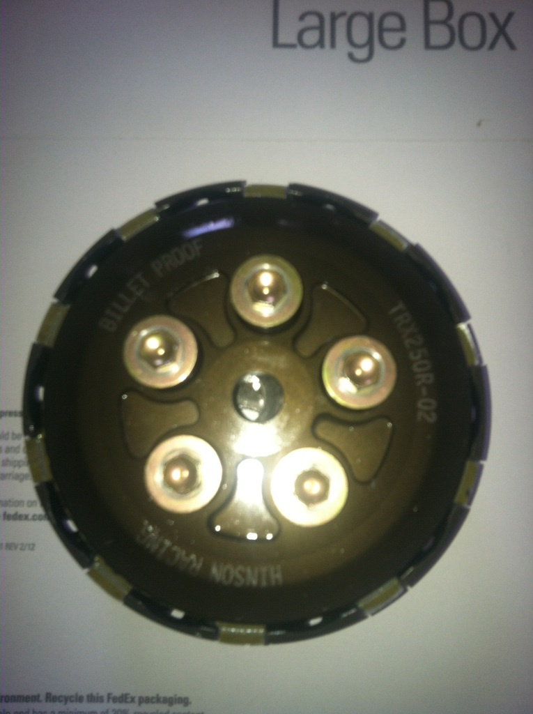

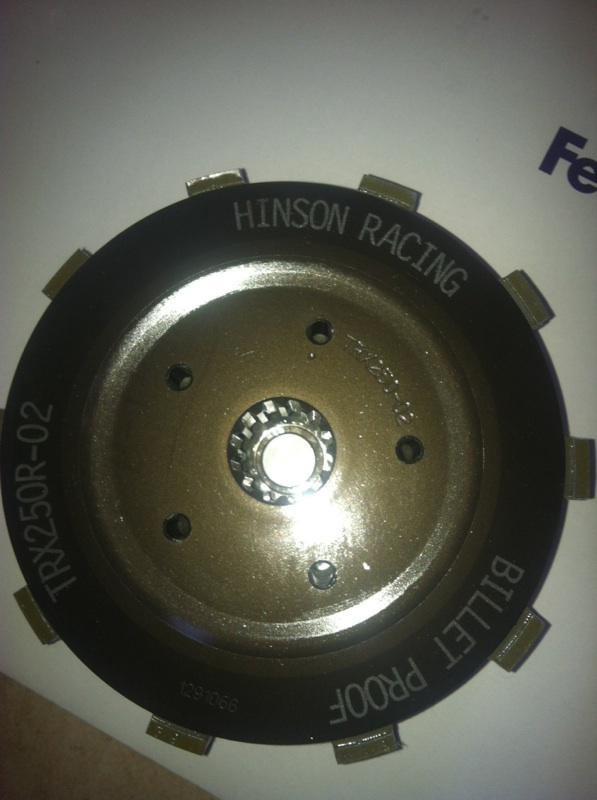

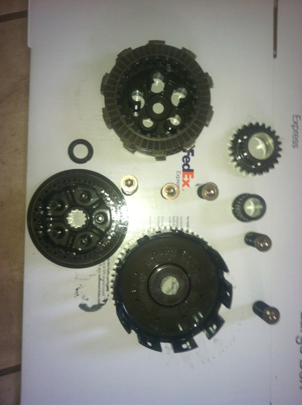

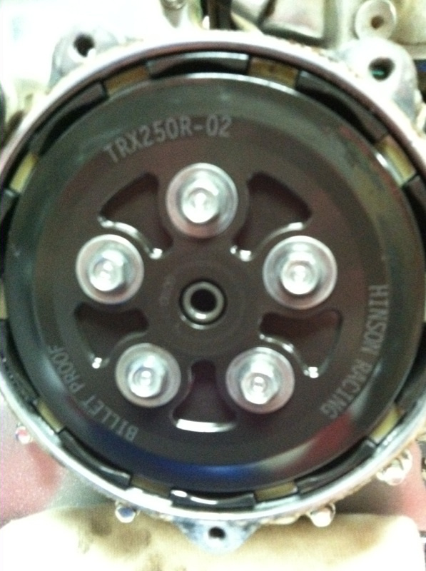

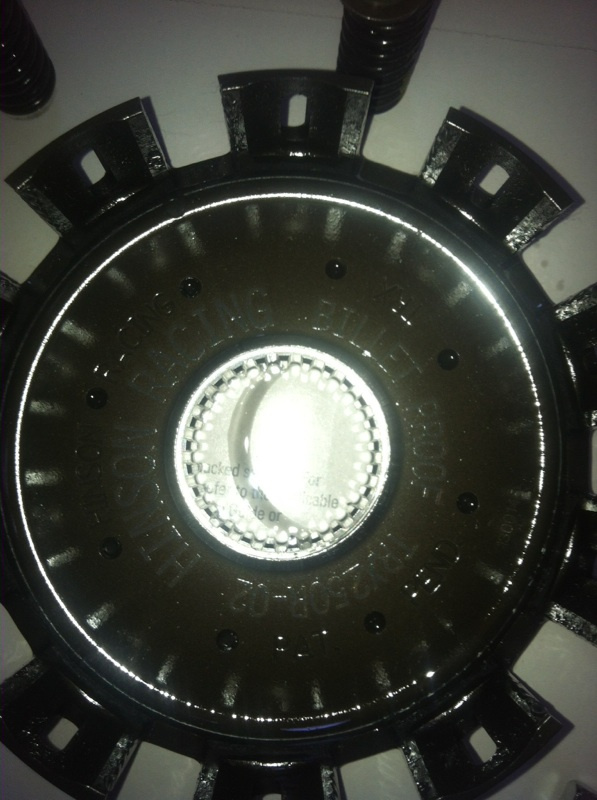

A member was gracious enough to send me some pics of his Hinson 8 Plate clutch setup so I'm going to post them for future reference.
Note that the pressure plate says "TRX250R-02" for the 8 plate.  For the standard 7-plate it should say "TRX-250R-01"
