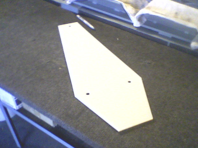

here is the akidplate i made from UHMWPE:

Quote from: jcs003;24532
That stuff looks like the shit.  Come to think of it, uhmw was the stuff that was preferred over hdpe.

Thanks guys, very informative.  I am digging the plastic idea myself right now.  That UHMWPE material looks interesting, but I think I'll probably end up going with the GT Thunder one.  Can't beat the price.

I work with hdpe all the time. Its food grade. I make all kinds of stuff with it. We use mostly 1/2" at work so no bending the stuff I have. Flat pieces no problem. Hdpe will take a beating. A hard hit will do nothing to it. The same hit would dent aluminum. Not to say its invincible. If you hit it hard enough it will crack.  The thinner the piece the more prone it is to crack.
UHMWPE has more flex to it and not as prone to cracking as hdpe in the event of a hard hit. UHMWPE will not slide as much as hdpe. I would think UHMWPE would grip more then aluminum. For XC I personally would choose a hdpe skid over UHMWPE. Unless the course is rocky and for sure I would be landing in hard objects. In this event I would choose UHMWPE.
I ride mostly MX and still ride with my AC kick up belly skid. Its not all that needed but it gives me piece of mind.
All this stuff can be bought at a plastic shop. I just picked up 2-1/2"x4'x8' and 2-1/4"x4'x8' sheets. Total was $1150. I'm sure its cheaper in your neck of the woods. Buying scraps would be best.
Any type of saw will cut this stuff. Table saw, skill saw is what I use the most. A Router can be used to knock down the sharp corners. low even heat will bend it. Bend beyond your desired angle. This stuff does not like to change form.  Once bent hold in position until it cools.

I've looked on ebay for 1/4"x12"x48" uhmw and have been coming up with prices around $50. I believe 1/4" will be plenty strong in our application. I did measure the quad. 12" will cover the width and be plenty to work on bending it up front.
I've also been a member on pirate for a while. Not sure if I still pay $20 a year or not. I'm pricecheck on there as well. Spent many many hours on that site.
I do agree that the gt thunder is the best price and only requires minimal trimming. I just like having the option of having that front guard. I've read about basically heating up your bending surface (metal) and shaping your piece to the desired bend. Then you let it cool. For $50 I might experiment. Oh, and this price also included black colors.
