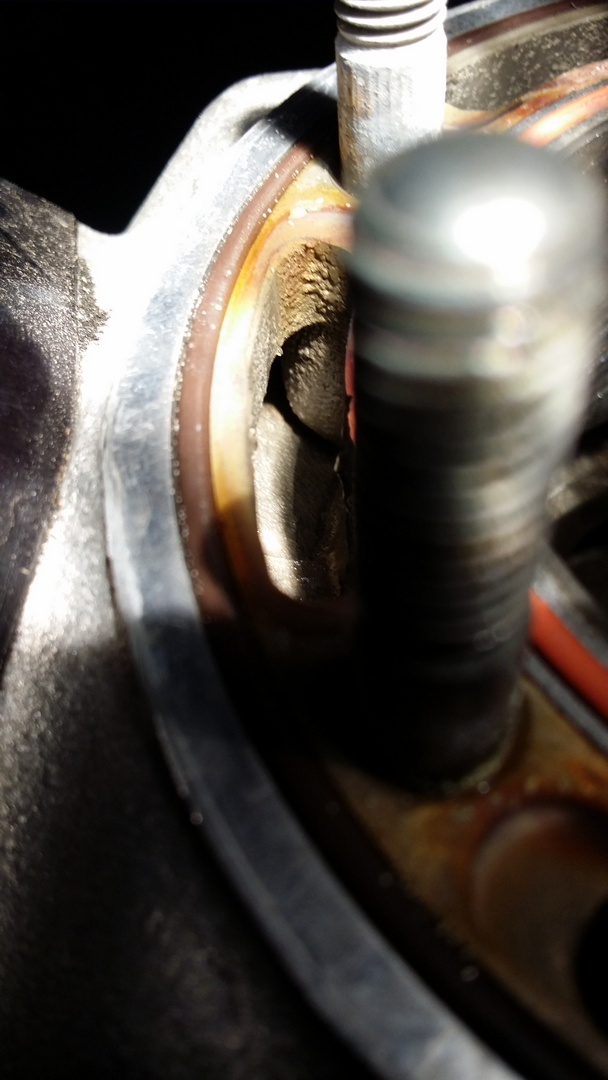

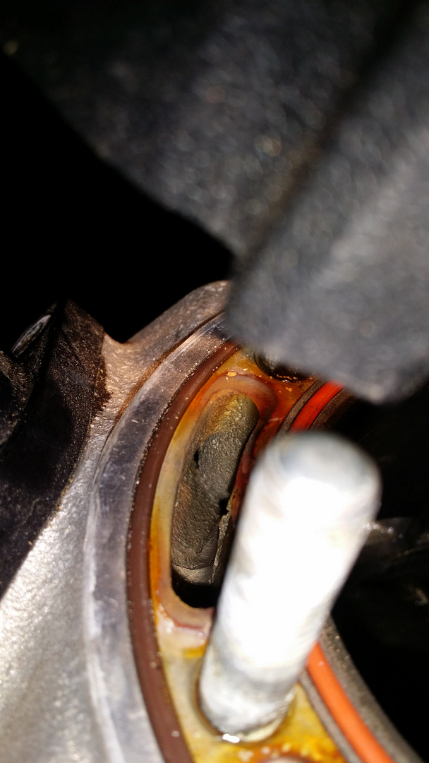

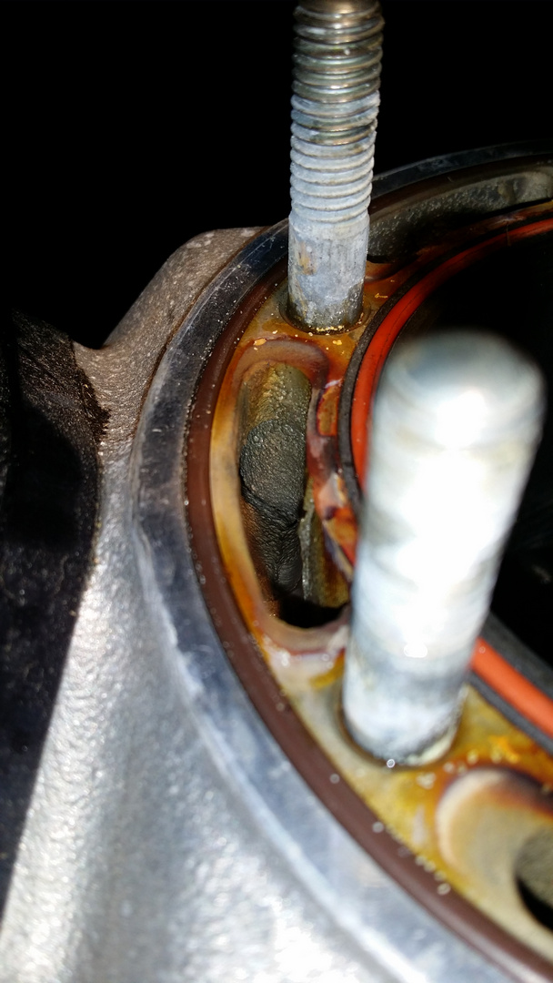

Does the passages above the exhaust port look to need milled?  I am going to ship back to ESR. I tried a lrd big bore pipe and it still ran 200 and it was only 60 outside. At a loss. Don't know What I am looking at there but there is barely any opening there. Hope the camera captured it.

Kinda hard to tell from the pics, but looks like that cylinders coolant jacket, is closed up a bit more than normal.
What some are doing, taking a long shank carbide & opening up a bit more down under the head stud casting & a bit just above the PV part, so more flow can pass over the top of the exhaust port.
Lets see a pic of the head as well, make sure the head only has small holes at the rear over top of the intake area.

The last picture makes the cylinder look OK, IMO

Oscar, that looks very familiar to others, that have had cooling issues. I opened that area up, over heating problem, solved.

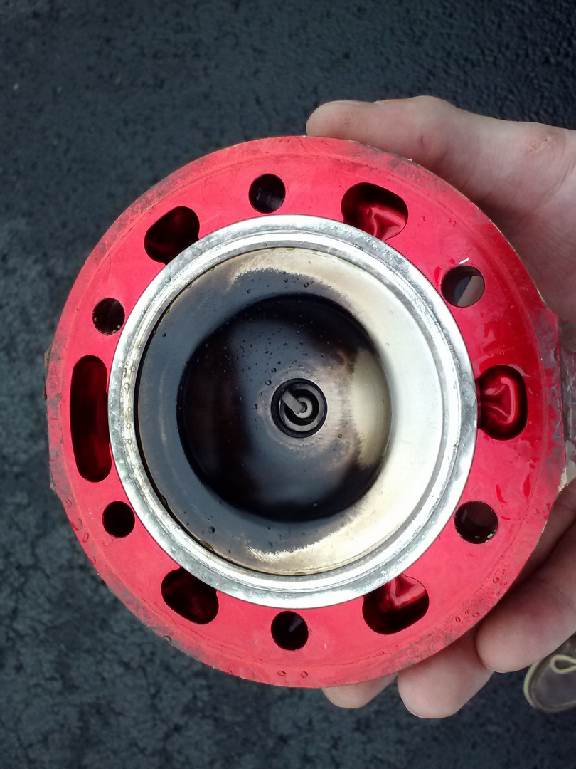

I am 98.9% sure that all esr billet heads have smaller passage cut to the rear over the intake, always have. There were other companies that did oring style billet different but it wasn't esr. Take a look at this area and under the dome again trx250scar and you will see it. I think all that ever searched for added cooling over the ex were the non pv with pv like yours not needing more flow there. Solid casting vs being cut out for the pv related to expansion or something like that. But esr did start opening that up 6 months ago or so when they started to cut the base nut seats. I think they got a new tool or something and while playing with thier program made those changes if I remember right. Anyway it deffinatly would never hurt to open it but don't know if it is a problem for you.

I responded to your first question which was "do you think it needs milled", it hard to say with the pics you took but the 3rd pic looks like there is enough water jacket around the stud to feed enough water near exhaust port area.
But after rereading you then state that the bike is running hot, well milling out the water passage over the exhaust port will NOT fix overheating, infact it should add more BTU's to the cooling system. When have not enough cooling around the exhaust port like you asked about, you will normally have piston heat problems but that will not be seen on a gauge that will be seen with piston scuffing or seizure

Cool, no big deal you will see it. The cut outs in the billet are just smaller in the rear for less flow then the front. I didn't read the other thread but I assume the new large stinger style bb pipe ran the same temps as the b. I hope you find what is keeping your temps up soon.

Offline zcarlson12
ESR 330pv water passages?
« Reply #14 on: February 18, 2014, 08:57:19 PM »
This is what my head looked like when I took it off before I did a complete rebuild on my motor for reference. Hope this illustrates the holes they are talking about.
