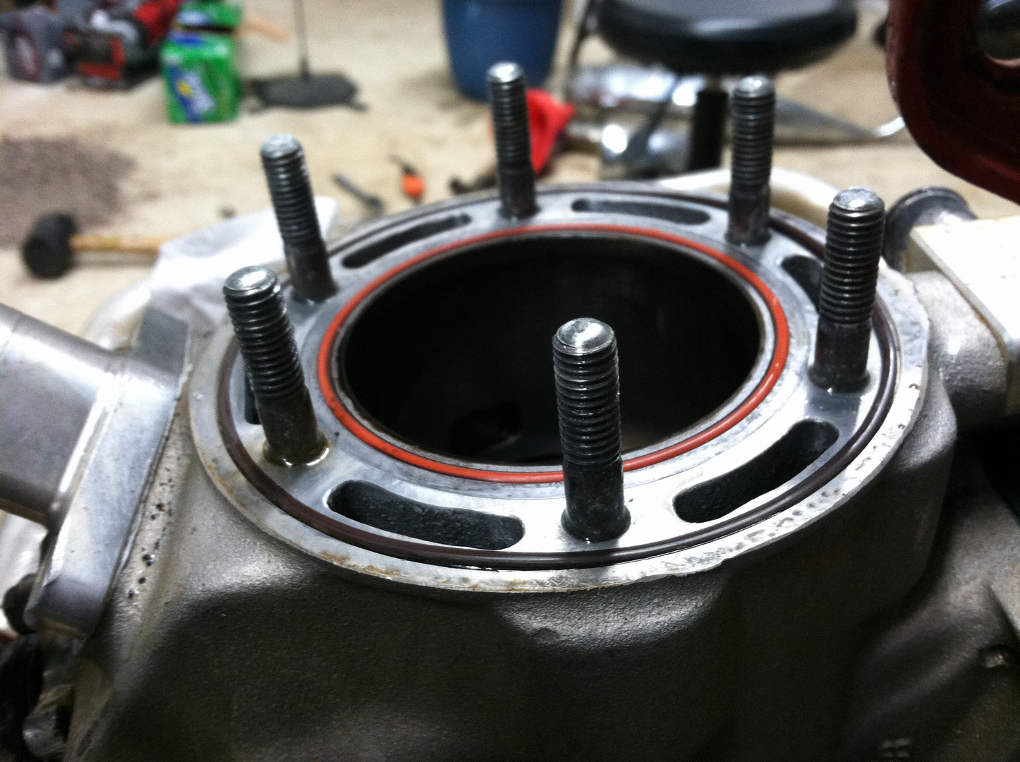

« Reply #25 on: February 21, 2014, 07:53:58 AM »
Turns out my head orings are good. Here is a pic. I checked them last night. I also took the R for a ride down the road last night and kept the rpms high. As long as I was moving fast enough to create some air flow, the engine was fine. It never got above 175. I think the main issue was just the slow riding conditions and the limitations of the radiator to cool the bigger bore. Everything is seems to be fine.

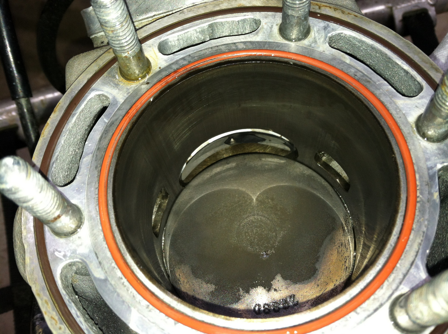

« Reply #27 on: March 08, 2014, 12:10:44 PM »
This is bad!

« Reply #28 on: March 08, 2014, 02:05:31 PM »
using them walmart orings ?   :highly_amused:
not only is it disintegrated but it appears smashed flat. if its a fairly new oring i would suspect very poor qaulity
