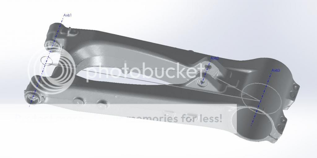

I can make a link not a problem, I have full CNC machine shop at my disposal.  The biggest issue you will have to have a shock setup for this link, which can be big $$.   I don't see many, (1 or 2 guys)  that will spend the money for a shock correctly setup for a long travel linkage.

But what I calculated was with a stock 250r frame, stock 04 450r swingarm, 08 dog bone, and a new link that I designed.  This is for a total length shock of 17", I can go higher but you lose progression.
