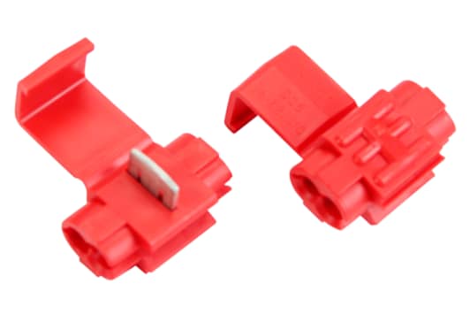

If you take these 3M wire connectors/splice and one wire from the tether and go to the Blk/Wht wire and then take the other tether wire and go to the Black wire it will work
What is nice about these splices is it does not require cutting any wires, I normally use a little di-electric grease with them and then use electrical tape over them

Dave this is the first time that I have to disagree with something you've said,
those vampire style connections, aren't the best choice for off-road vehicles.
After time and vibration and mud and water the connection between wire and connectors teeth will degrade.
The wire will start cutting from the teeth and vibration then once strands have been cut, it will start having higher resistance, creating heat at the connection point,
and over time those types will fail leaving the wire isolation brittle and the strands cut...
they are ok for a while but for a more permanent trouble free splice, you cant beat solid crimps joints, or solder joints and insolate with heat shrink with the adhesive melt inside

well I do admit they are not the best connection that can be done, but I have also seen plenty of poorly crimped connections from using the typical multi-purpose cutter/stripper/crimper like this:
If you are going to do a crimped connection then I highly recommend the ratcheting style like this:
I always use a little dielectric grease on the blade area to help seal the connection and the natural tension of the wire sheathing also helps keep the connection resistant to water.
I have probably every type connection either in my shop or available at my job, yet I do still use these from time to time simply for the quick
convince or the in the case where I want to remove it at a later time and with just a sample piece of shrink tube the spliced area is repaired.
My enclosed trailer was completely wired using these connectors from the factory and I have yet to have issues from them.
But there is better connections as you have mentioned and I would recommend using them as long as a quality connector and crimper is used.
But please avoid the cheap connectors and multi-tool crimper's from places like Harbor Freight other wise I would go with the blade splices I have shown along with a little dielectric grease.

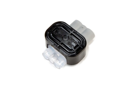

Now I have wired up trailer lights and instrumentation at work with these style 3m grease filled connectors,  and they are awesome and have never had a issue with these either, but these you insert the ends of up to 3 unstripped wires into the piece then squeeze to splice the 3 together
