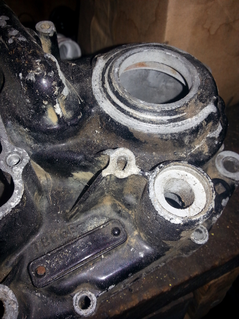

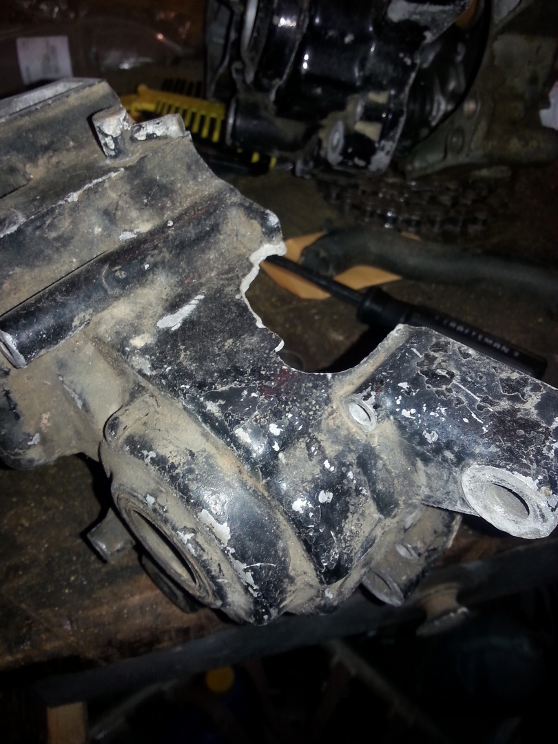

Where can I get cases repaired? I have two left center cases that needs repaired. One only needs a lower case saver fixed the other has a large hole on top of case infront of rear top engine mount. Cheaper to send out and get fixed or get new cases?

post photos of the damage. im sure jerry can say if its worth the hassle of fixing. most any type of damage can be patched back together but sometimes its easier to get a new part
Offline aberegg05
damaged cases
« Reply #3 on: March 30, 2014, 08:59:15 PM »
Here's some pics of cases
« Last Edit: March 30, 2014, 09:10:54 PM by aberegg05 »
Offline aberegg05
damaged cases
« Reply #4 on: March 30, 2014, 09:12:33 PM »
I'm not real picky about looks. Just want them to work and keep for spares for "just in case" lol

Do you have that big chunk that was busted out of that one case half ?.
If not, it will be a lot of welding repair to fill in that area.
A good rule of thum when wanting cases repaired, not to have big broken out areas where a gasket surface is located, because once the welding repair is complete, that gasket surface will need to be resurfaced to make it flat.

No I dont but I do have a junk left case I can cut the chunk out of
damaged cases
« Reply #9 on: March 31, 2014, 03:27:18 PM »
You need to check the main bearing bore. If it is sloppy (bearing slides in) then that needs to be taken into consideration also. The lower case saver is an easy fix. But I saw a BDT repair on .net where they welded it all up and machined it back to perfect. Great waste of time and expensive. It just needs to be cut off and have a threaded spacer welded in.
Offline aberegg05
damaged cases
« Reply #10 on: March 31, 2014, 04:07:19 PM »
What is the bore supposed to be
damaged cases
« Reply #11 on: March 31, 2014, 07:41:10 PM »
Quote from: aberegg05;30402
Tight enough you cannot push a bearing in by hand
