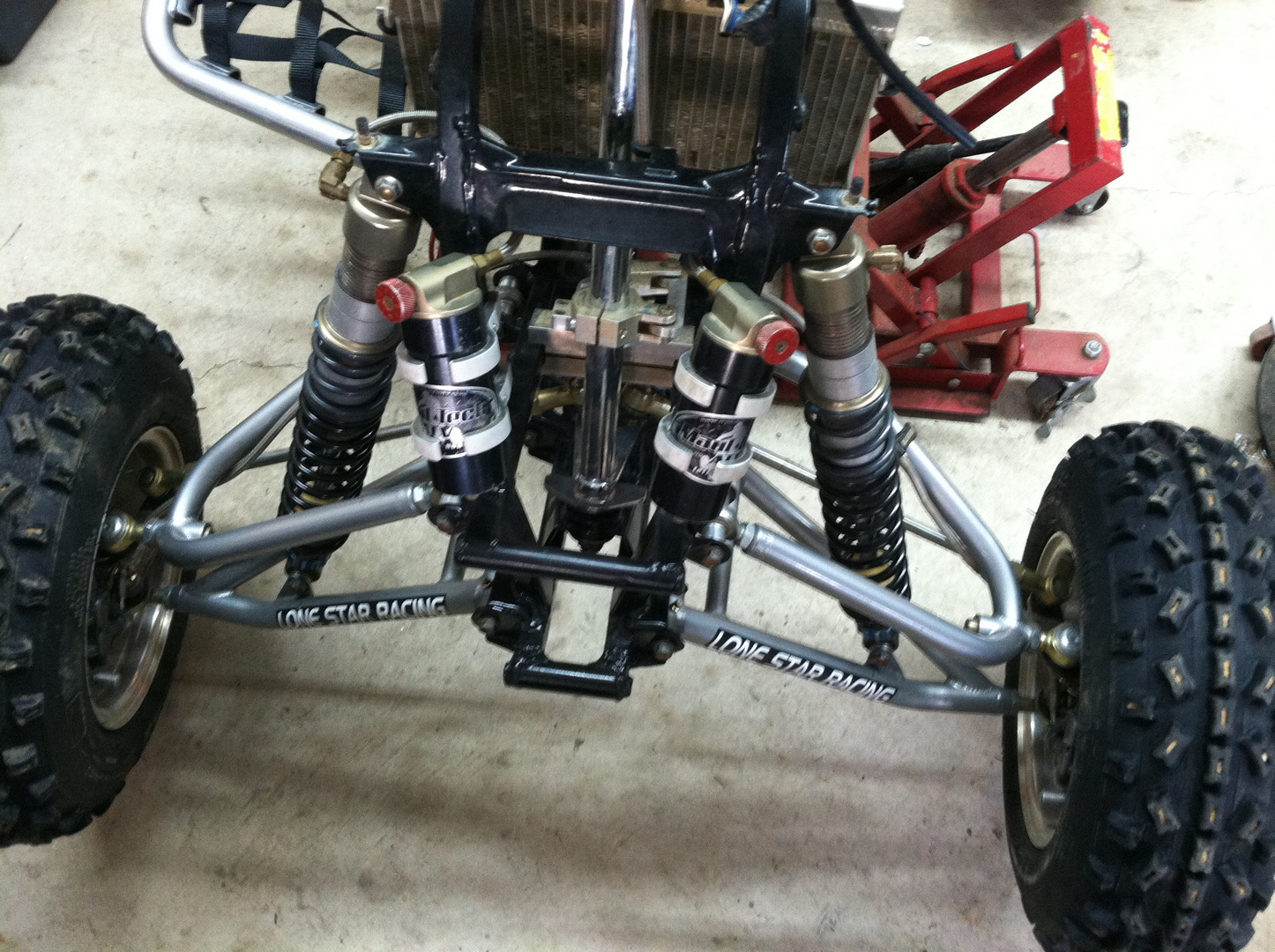

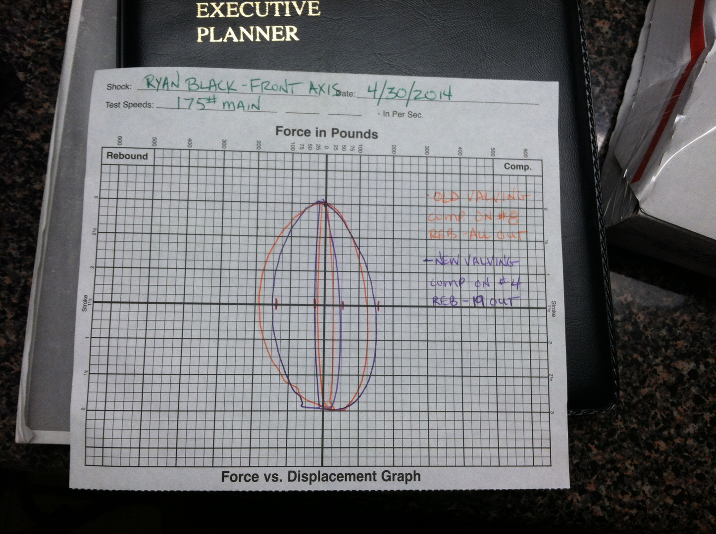

Update: got my front shocks back for Andy @maultech and got them installed. He also included they dyno sheet of how they were tuned when I sent them in and where they are now. I am very excited to try these bad boys out! You may have noticed that the shocks are now only dual rate springs instead of triple rates. When Andy spoke to me, he said that dual rates and triple rates can be set up to perform the same and that the 3rd spring is not really needed. He said that the dual rates were just easier to set up and that the dual rate would actually give a more plush ride. While this seems a little strange to me, I am more than willing to try it out. If it performs that much better, I don't really care how many springs they have!  Maybe if he see's this post, he will chime in and explain it a little better than I did.

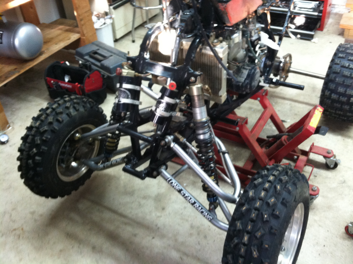

Here is a first look at my new Rath Racing nerfs almost installed. I haven't drilled them holes that bolt them to their mounts yet; will probably do tonight. I just wanted to see what they would look like. I am gonna really enjoy using these. They got some serious grip!

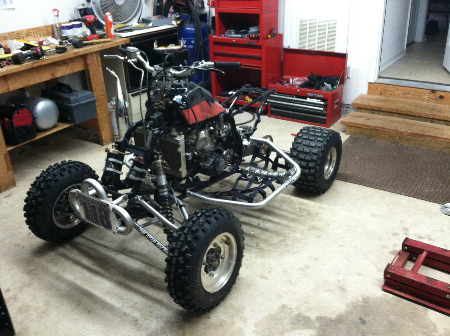

She's almost a rolling chassis! Won't be long now.
Here is what my laboratory is looking like.
Work bench is loaded down with junk
Parts strolled around everywhere. Here is my grizzly contributing as well. My race gear is in the gray tote.

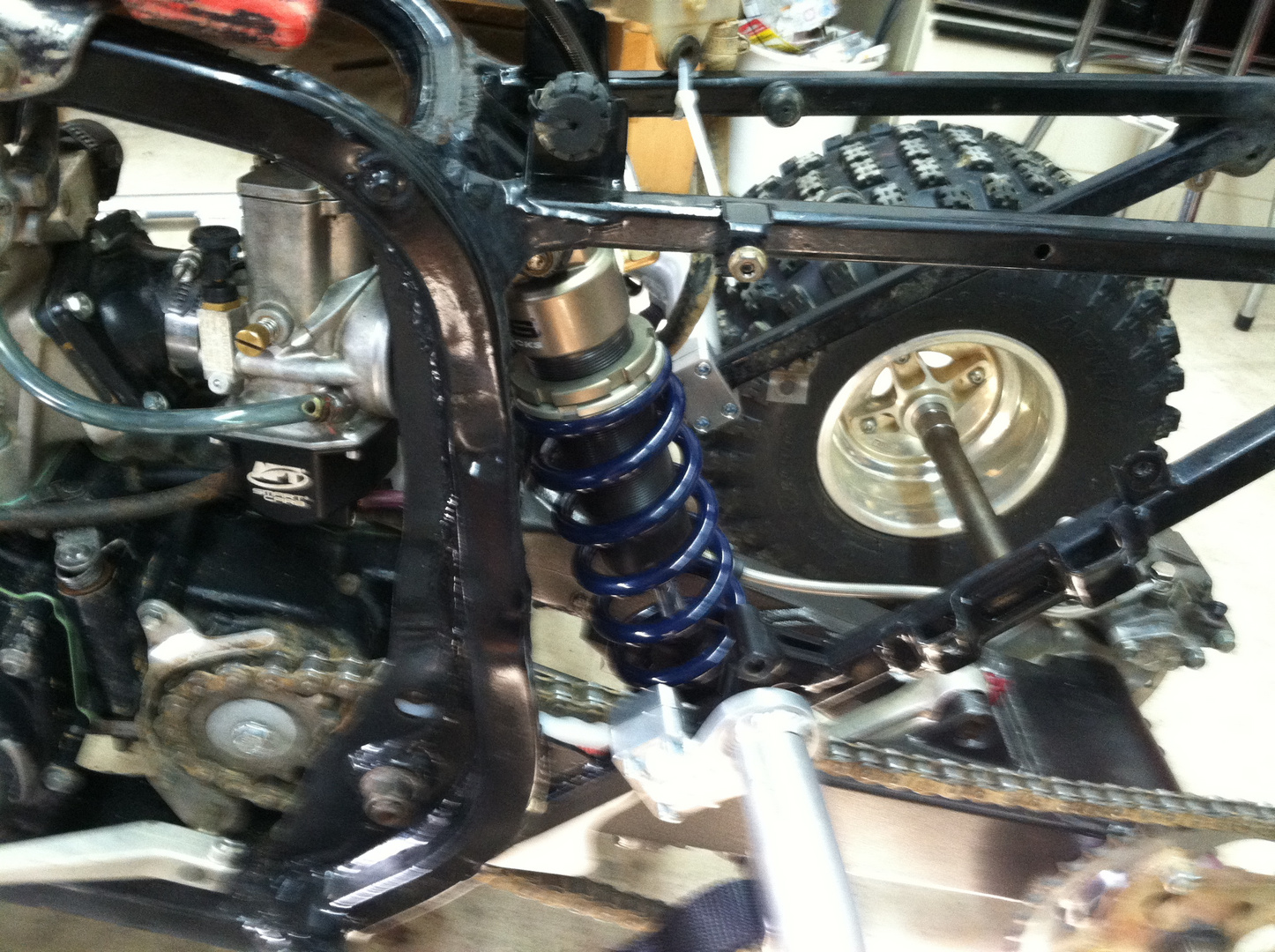

Got rear shock mounted up. Finished drilling the holes for the new nerfbars. Once I got some good bits, it was like a hot knife through butter! Got the new rear brake pads on and rear brake bled. Everything is prettymuch finished on it now. My rear sag is a bit off, so I will probably have to swap the rear spring out for a lighter one. I will be posting my obvervations and experience with how this new girl moves and sways once I get a chance to ride her.......err.......I  mean....dance with her.

Everything is almost ready to go. Custom Axis sent me too heavy of a spring on my new rear shock. So they are gonna ship me out a lighter one. This won't take long to change; then I will be good to go for the race this weekend. Andy @maultech has been very helpful in getting me set up and ready to go with my suspension. I learned something new this weekend that I would like to pass on. Some of you may already know this. I knew there was a relationship between rear sag measurement and spring rate but I didn't know what that was til now. It goes as follows: For every 25 lb spring rate change, it equals a 1/2" of sag. In other words, my rear sag was 3-1/2", it is supposed to be 4-1/2". So to get the additional sag, I have to drop down 50 lbs on the spring rate. Thought I would pass on that little nugget.

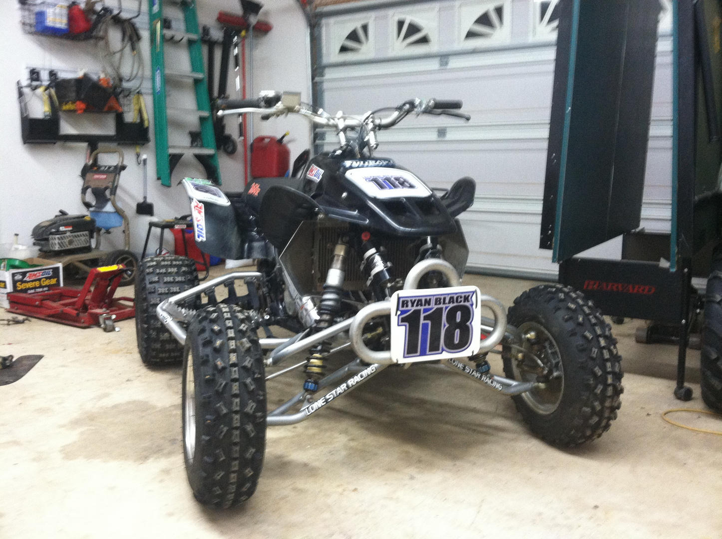

Just for a little nostalgia, this is what my R looked like back in 2000 shortly after I first bought it.
I have spent countless hours in my man cave burning the midnite oil with this lady of the night. She has seduced me with her curves and cut me deeply when she was not getting the attention she demands. But she is finally ready to get out and tear up the track. While she does not drink much, she is a smoker. A racer once told me, "a good quad should have a name."  Ladies and gentlemen, meet my lady in black.......Shadow.
A big thanks to Andy at Maul Tech for working with me on my suspension and Custom Axis for their customer service. My suspension feels more plush than it every has. Granted, I haven't ridden it on the track yet, but I notice a difference just bouncing up and down on it and even jumping up and down on the grab bar and front bumper.
