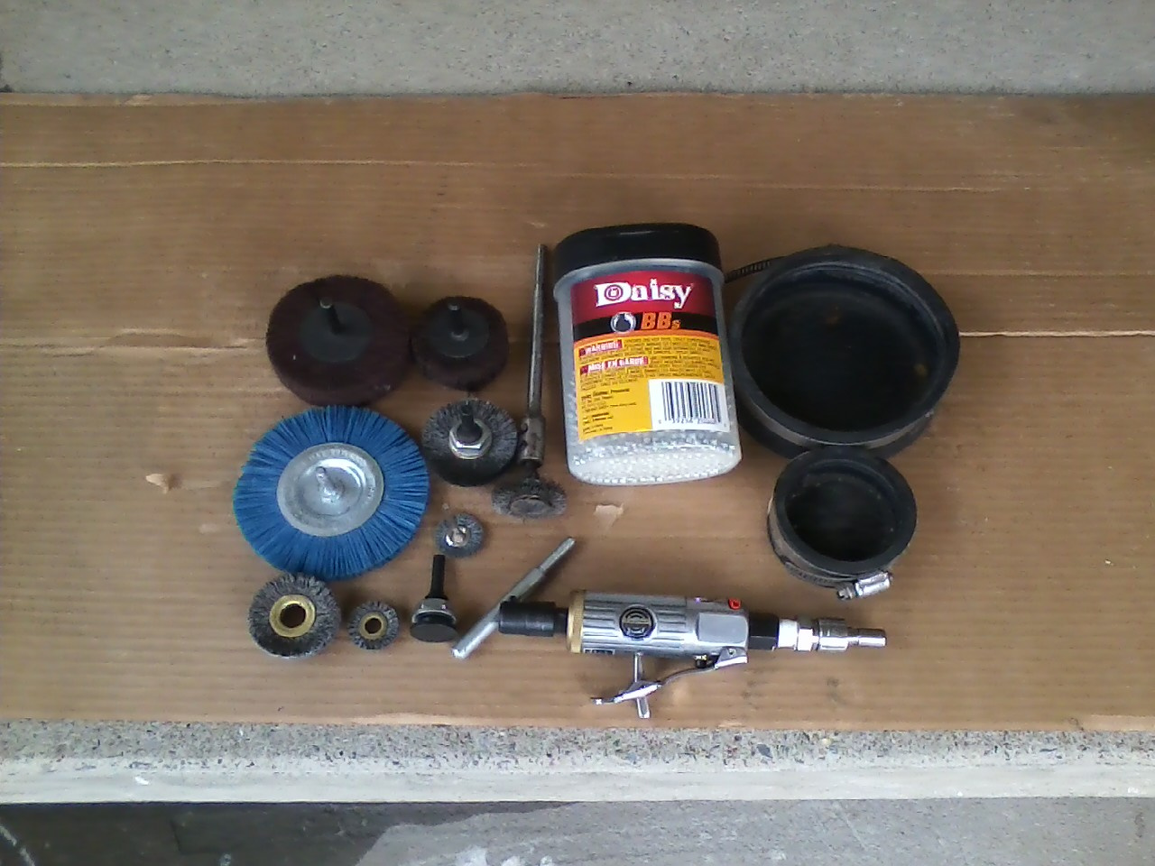

various tools and tricks are used when trying to remove the carbon from the inside of our pipes.  shown below is the assortment of the tools that I use with the aid of easy off over cleaner (use the name brand stuff and not the generic).  caps to seal off the ends when the oven cleaner is doing its magic (bb's poured in and then lightly shaken).  wire brushes in .010 and .020  wire diameter and various shank mounted brushes.  I was lucky to have worked for a brush making company for 10 years so I did accumulate a lot of deburring/cleaning brushes.  at one time I even made up some tapered brushes (all gone now...worn out).  we have discussed this topic elsewhere....so what are other guys using/doing?
