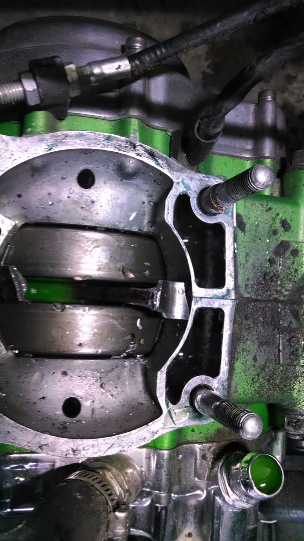

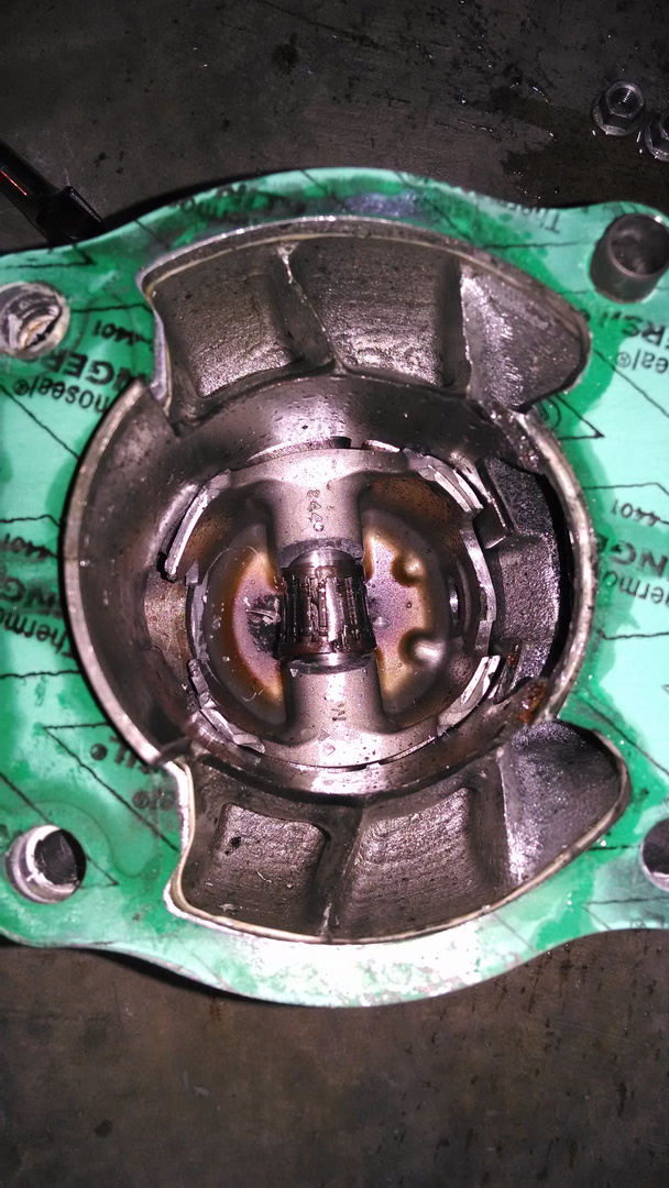

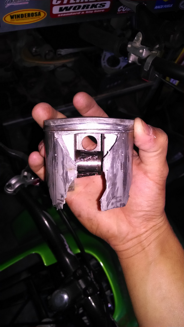

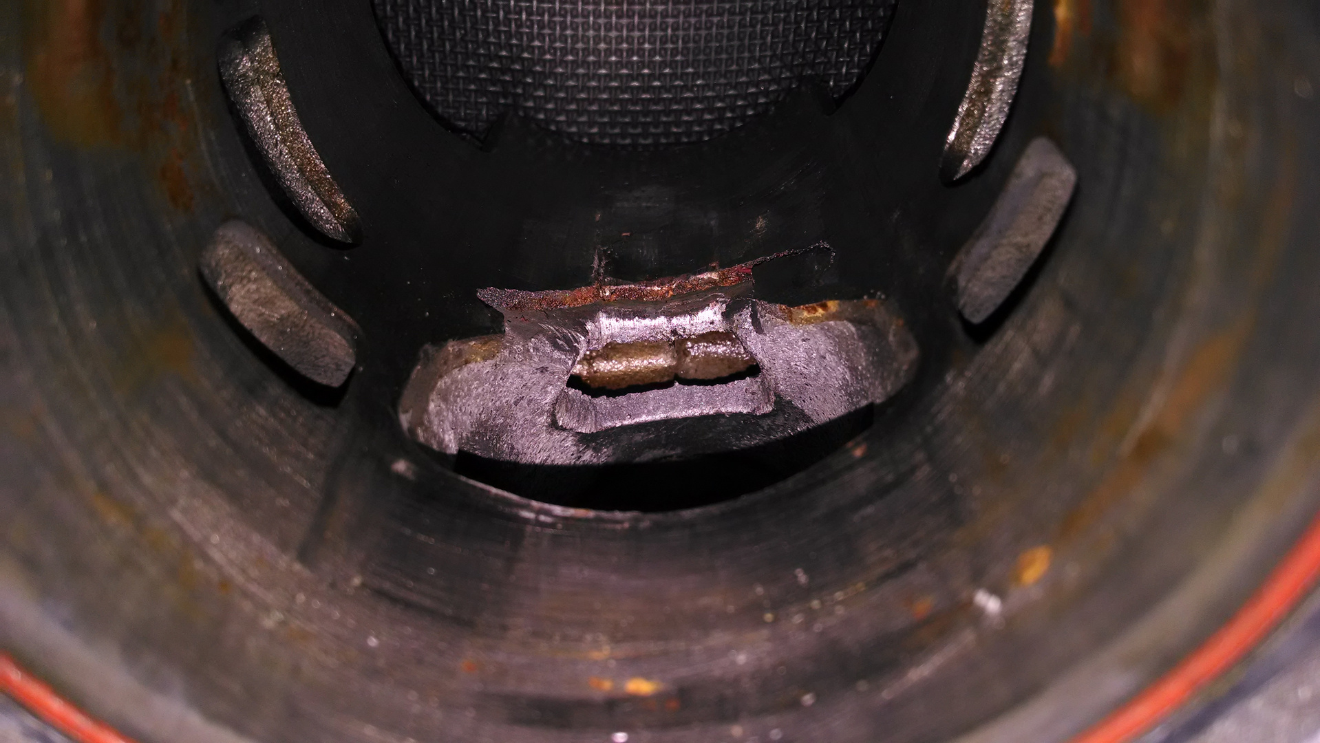

well guys, looks like this cylinder and crank are done. Ran very well for the time that I had it but time to move on.  any input is welcome.
Its pretty heartbreaking.... almost like a really bad breakup. But the bright side is that it took out my dads bike a couple times (his bike still has a lot of potential left in the setup), took out john safarians 420 a couple times and ran with a few alky shees and a beat a couple of 4 strokes this weekend

Alot of guys don't think about replacing the wrist pin bearing or rod bearing when they do a rebuild. Does look like you were having fun up until this point.

I have seen this type of connecting rod failure many time on the aftermarket connecting rods but never on an OEM Honda rod. Who manufactured the connecting rod??
Show us both sides of the connecting rod so that we can identify the con rod manufacturer.

its a pro x rod by ESR. I will post pics of it once I get it apart. I cant get the rod to pull up.  its sitting on the table still. haven't had the money to get it in a chassis yet.  I was getting close but now this happened

shit happens unfortunatly sometimes. thats first prox rod ive ever seen broke

Johnny, I had a similar failure on my first oem drag cylinder.  Lost the wrist pin bearing, then rod, then piston just as it appears you have.  Bad feeling right there, something that doesn't let you forget quickly.  I'm impressed she was hangin with Safarian's 420.  NICE!!!
