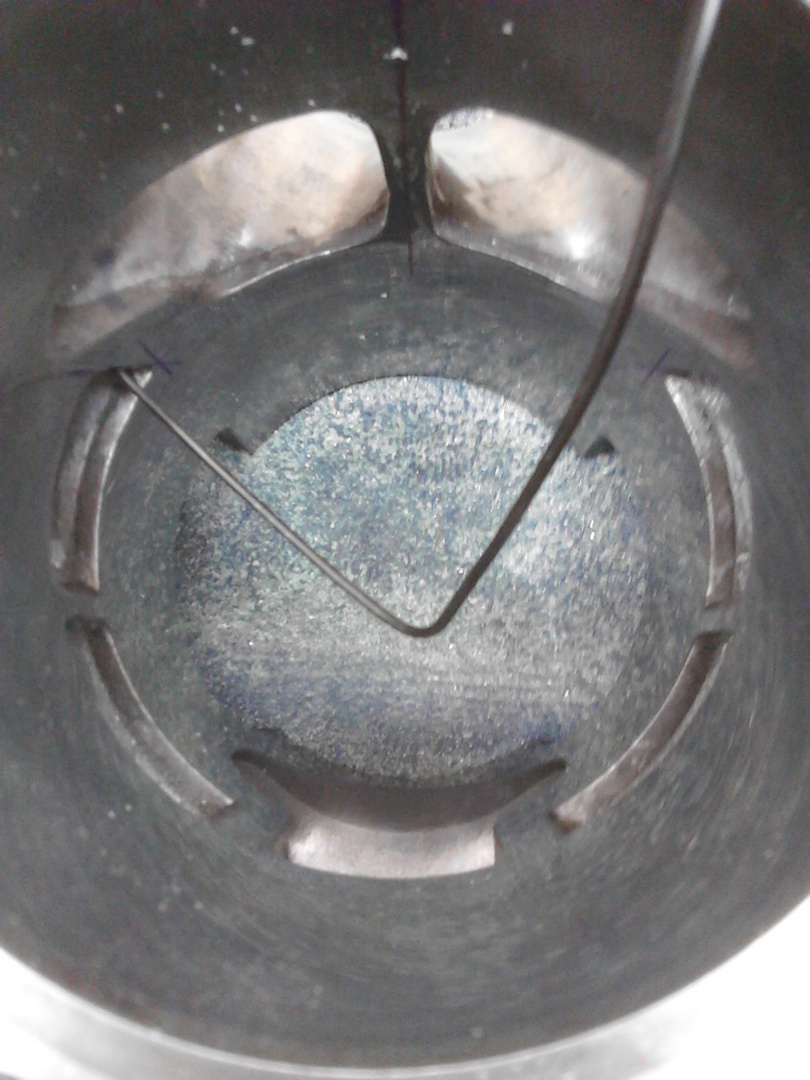

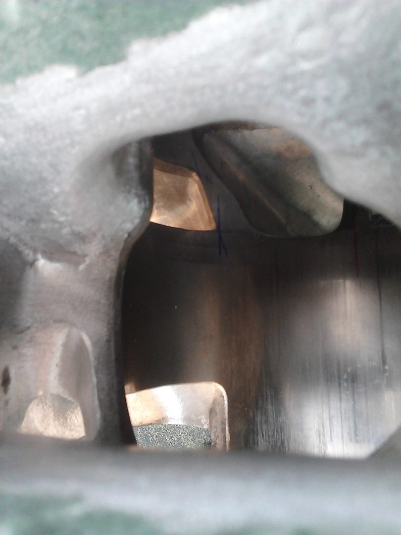

« Reply #19 on: July 06, 2014, 05:36:45 PM »
moved the front angles back alittle and traced where everything runs  into the bore. i think it should work ok
