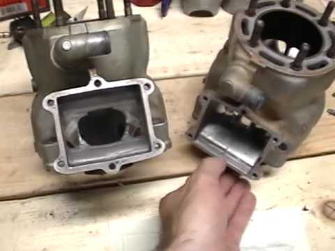

What year is the Cylinder ? Look in the Intake and if it has two vertical supports its the '87-89.....if it's a big opening with two smaller openings to the bottom left & right....it's an '86.
'86 on the LEFT....'87-89 on the RIGHT
