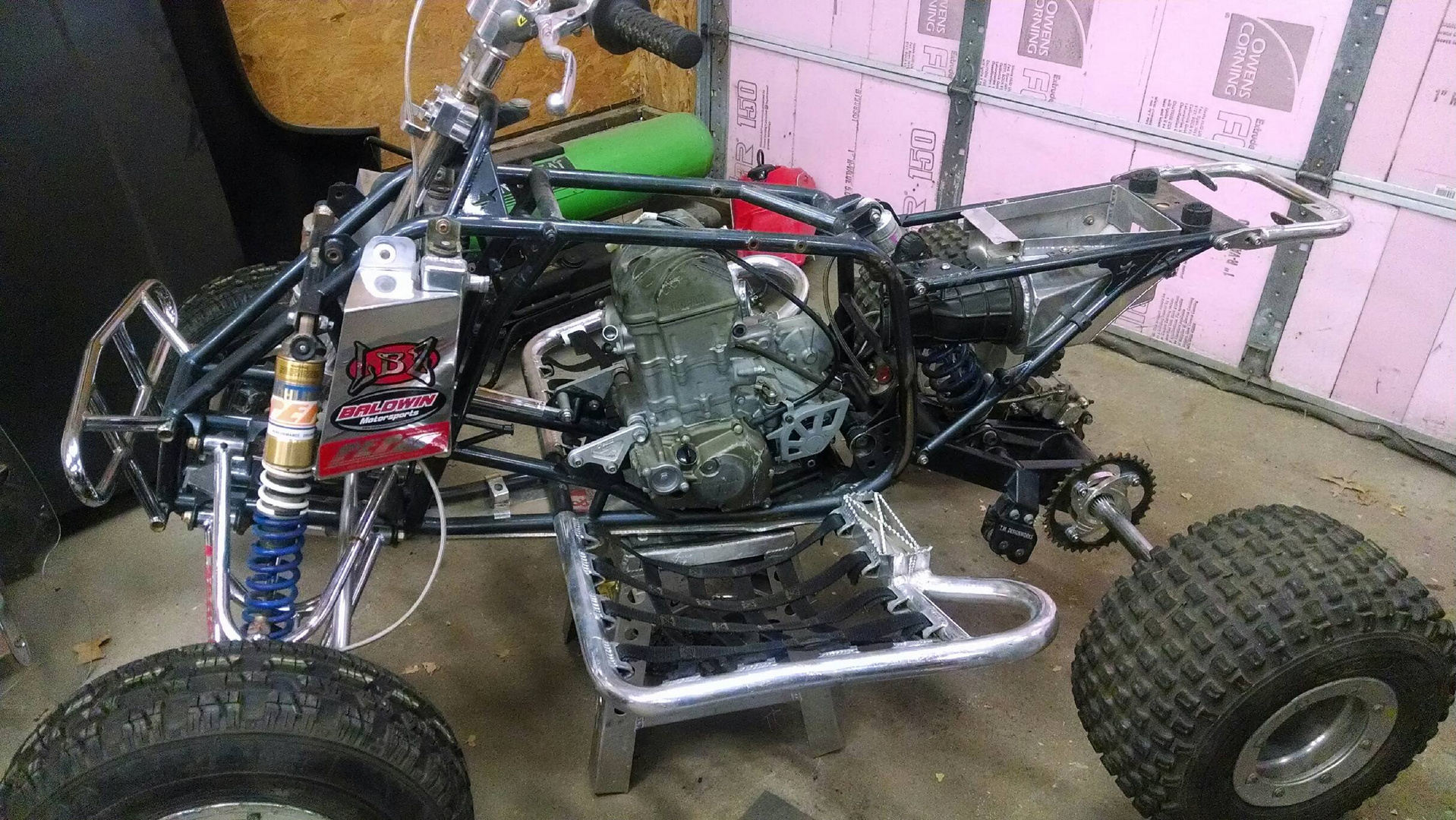

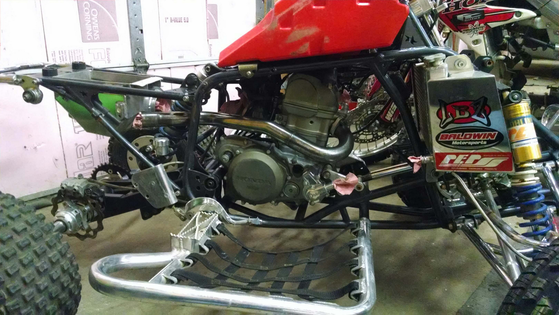

A little bit of progress
« Reply #26 on: March 28, 2014, 10:33:18 PM »
Got the motor set in the chassis.

« Reply #27 on: April 05, 2014, 02:16:47 PM »
I tossed the idea of using my trx motor also that was a nightmare I picked up a crf also. What did you do about the chain not lining up?
Offline 4Wheelmx
My LSR hybrid build
« Reply #28 on: April 05, 2014, 03:15:39 PM »
I bought engine pivot bushing from Walsh that space it out correctly.
CRF-450R Engine Pivot Bushings
Offline jeremy444
My LSR hybrid build
« Reply #29 on: April 05, 2014, 04:13:49 PM »
Awesome I will call them Monday. I am guessing you used the front engine mounts that came with the lsr 426 frame ?
