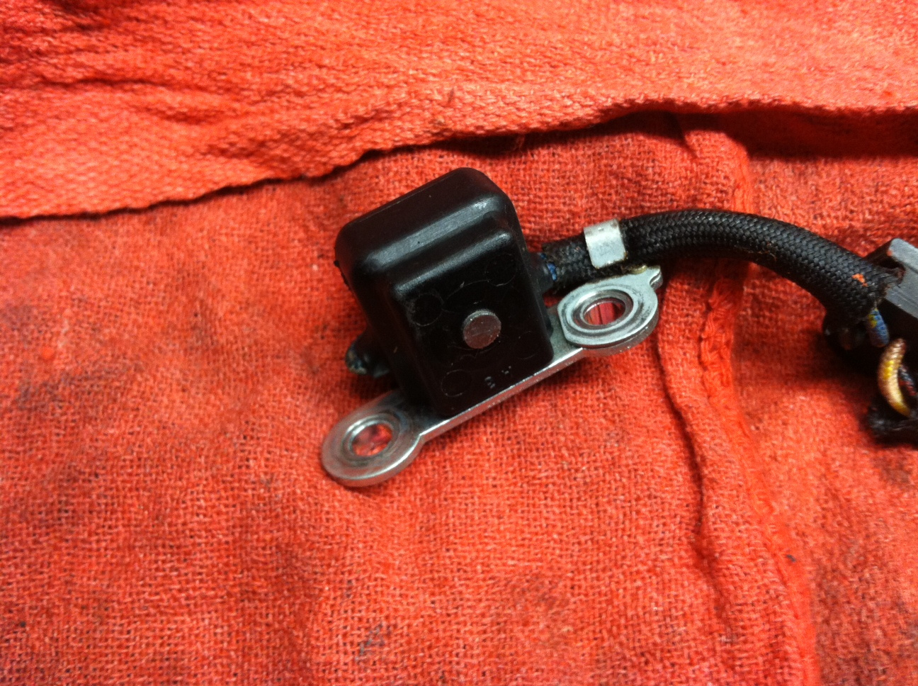

I'd say ignition I've never seen a oem one do that.  Can you take a pic of your flywheel and pick up coil. Maybe it has a timing advancer on it.

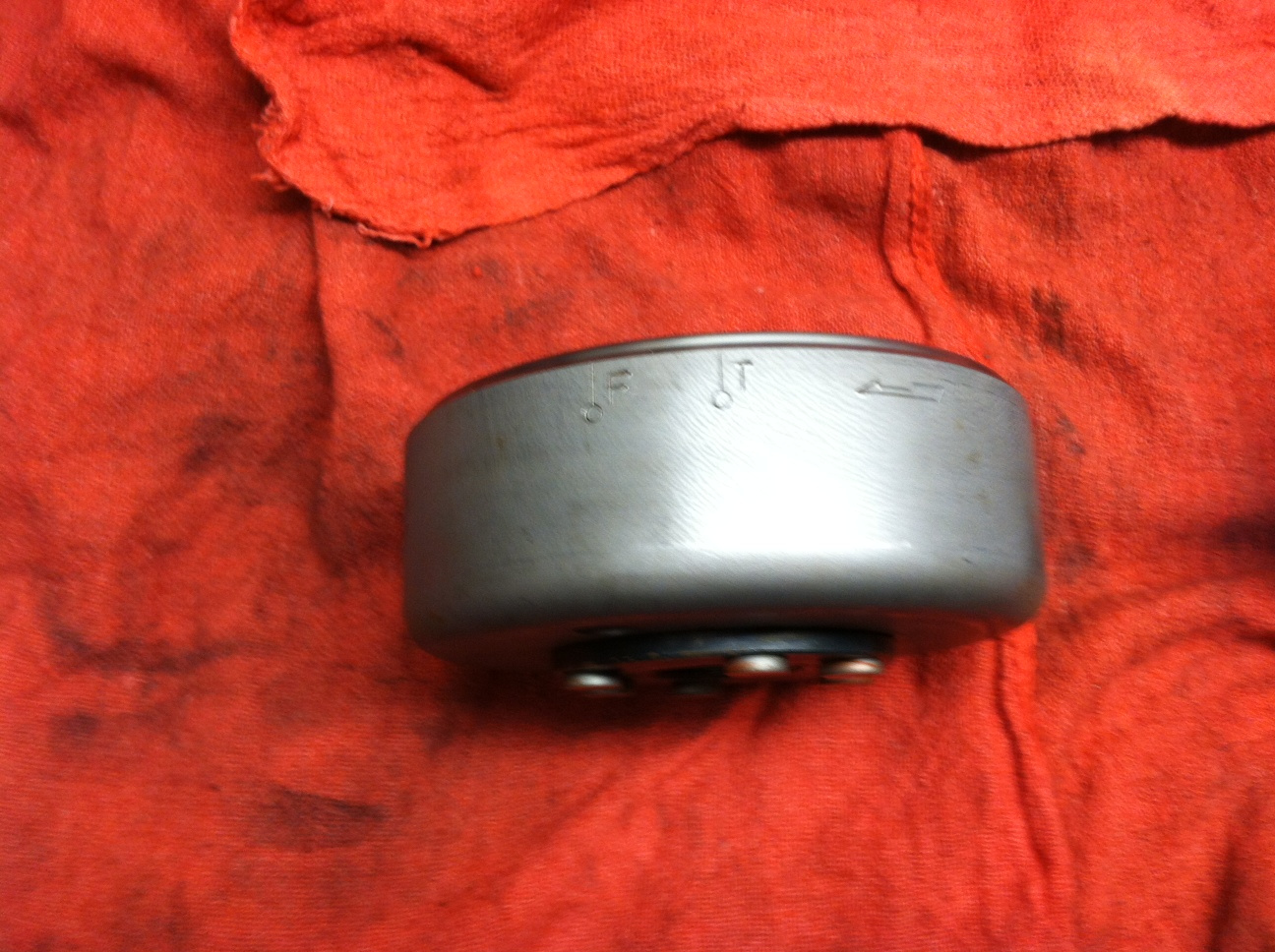

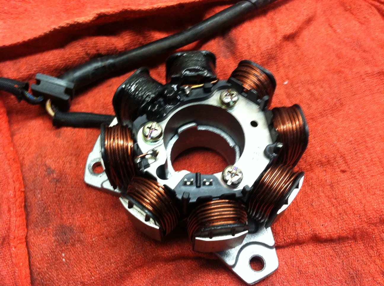

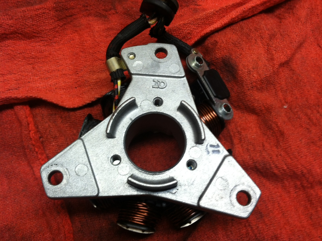

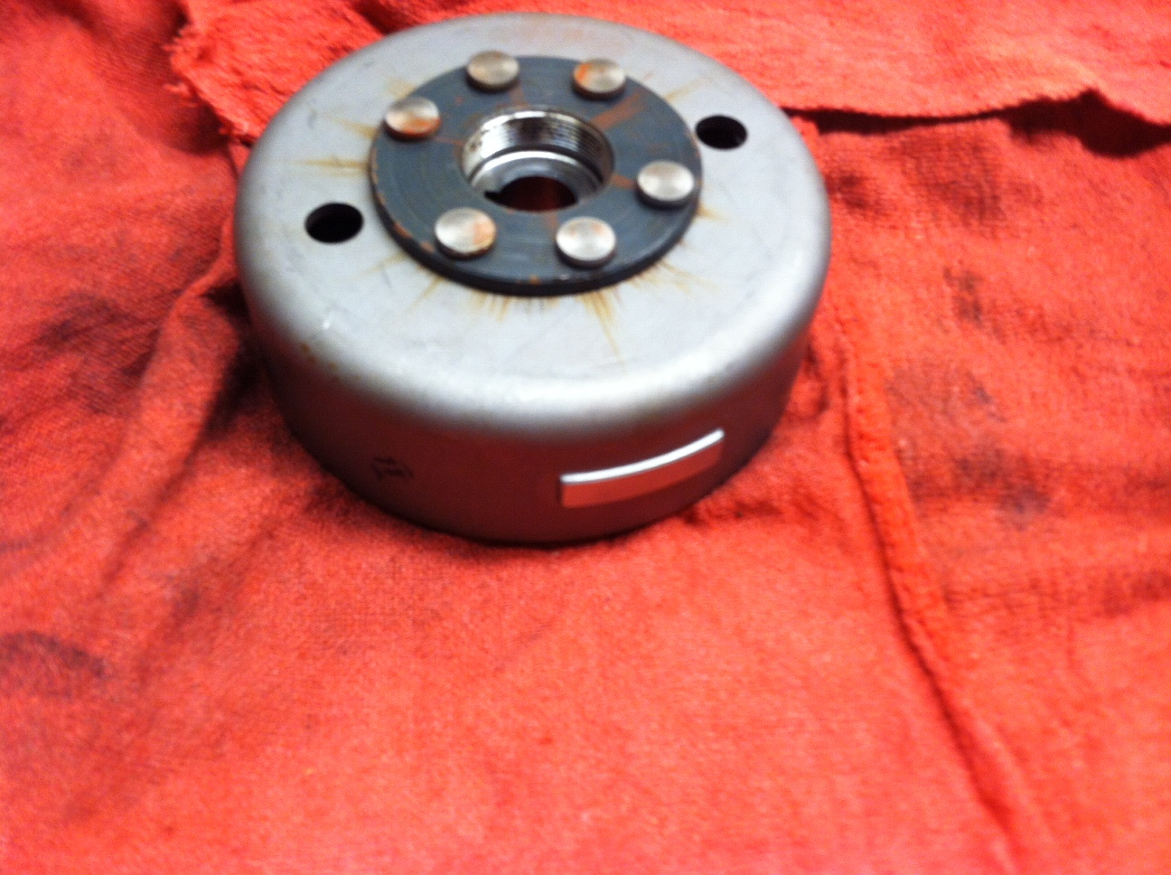

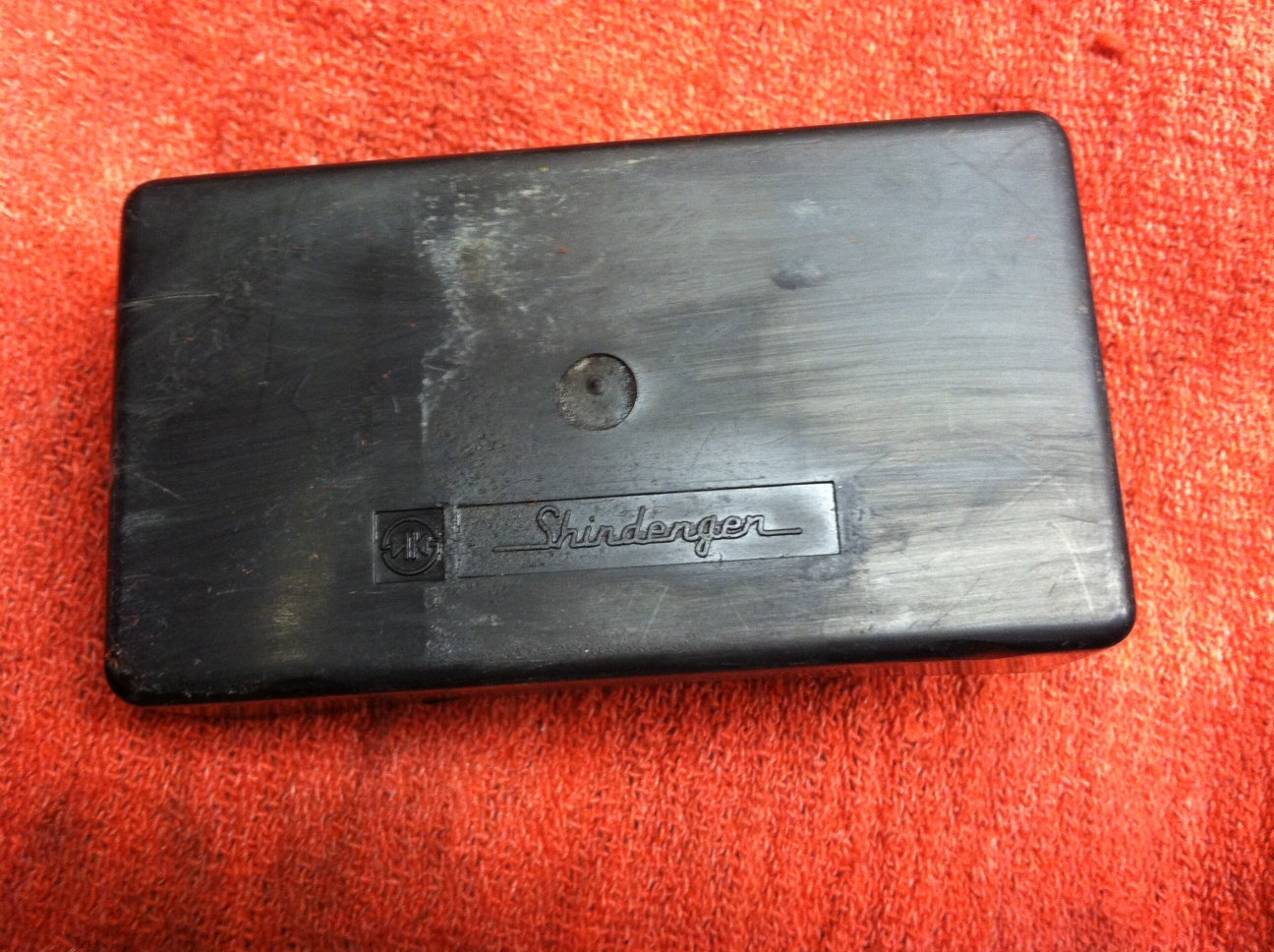

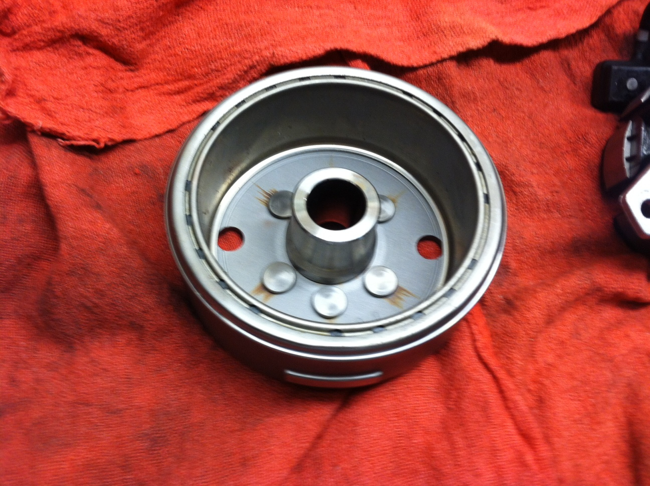

The carb is not the culprit, it was on my Zilla and worked fine.  The CDI is also one item that has been on both engines. Here are some pics of the ignition.
