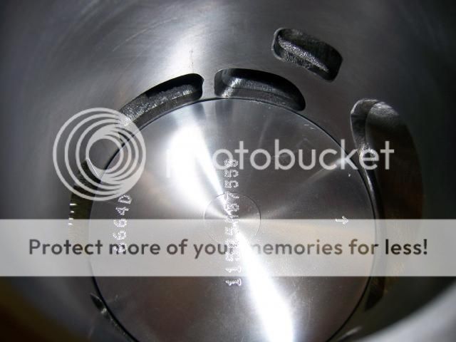

Drilling the lube holes in the piston.

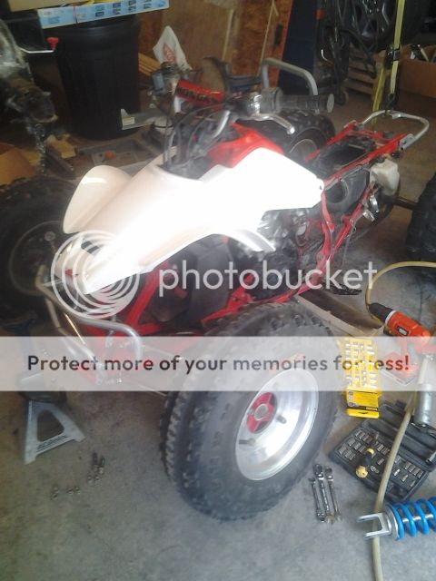

Slowly making progress. Seat cover and rear carrier showed up, but was stuck at parade and fair last night.
CBR radiator, Roll pegs, wire harness, CDI, regulator, 38A/S, and Alba bumper installed.

lube holes? are you drilling those all the way through the skirt so oil can splash up under and through them to the outside of the skirt while its traveling?

Do you need to drill the lube holes of you don't have a bridged exhaust port?

Quote from: JesseA420;40446
Yes, they are drilled all the way through.  The pistons come with a hole started for both styles of cylinder, bridge in the middle or two for the auxilary exhaust ports.  I drill the ones that line up with the bridge to help lube and cool it.  Something I read somewhere that I really don't know anything about.  I posted the picture too see if there were any comments about it.

Quote from: Tbone07;40447
No I don't see a reason. This one is drilled in the two outer sets of holes that line up with the bridge between main exhaust port and auxiliaries.

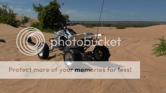

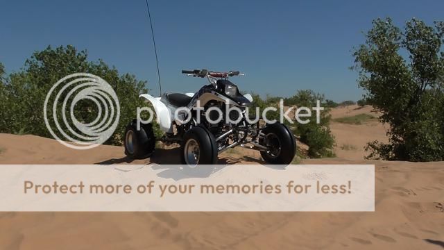

Got it mostly done and went to Little Sahara last weekend, the bike ran awesome, GT shocks were great, ESR 330 was great and faster than I thought it would be. Not much left to do now but send the seat to jettrim to get the cover to fit right, and change the back bumper. And I'll probably get some original style stickers for it instead of the machine head graphics.  I'll have a video up too before long.
