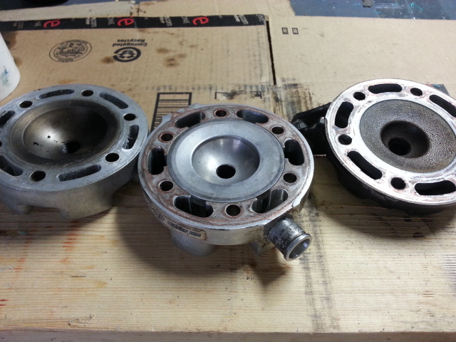

Here are the heads I was testing. Just for reference. The one on the left was the 30cc DNS. The one in the middle was the 18cc Cool Head and the one on the right was the 23cc stocker. I do not have a dyno, but from my testing the last few days, the stocker had the best power before the pipe came on which is what I'm trying to find. It had a snap that was a little more aggressive out of corners than the other two. The Cool Head felt a little flat. Like it needed a little more rpm to pull the same torque. The DNS felt noticeably more flat than the Cool Head out of corners. After the pipe came on, it was kinda hard to tell if there was any differences or not. I think the DNS may have pulled the hardest but only towards the top of the rpm range. The Cool Head and stocker were too close to tell. So needless to say, I put the stock head back on. :)
