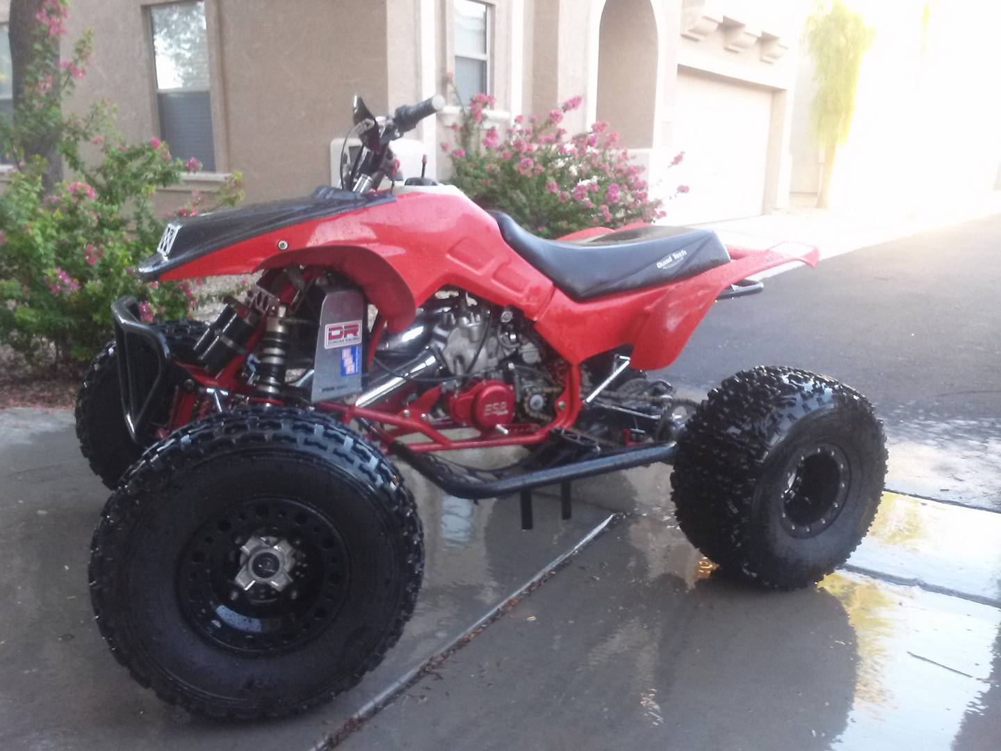

Im running 22s on the rear and 23s in the front.
