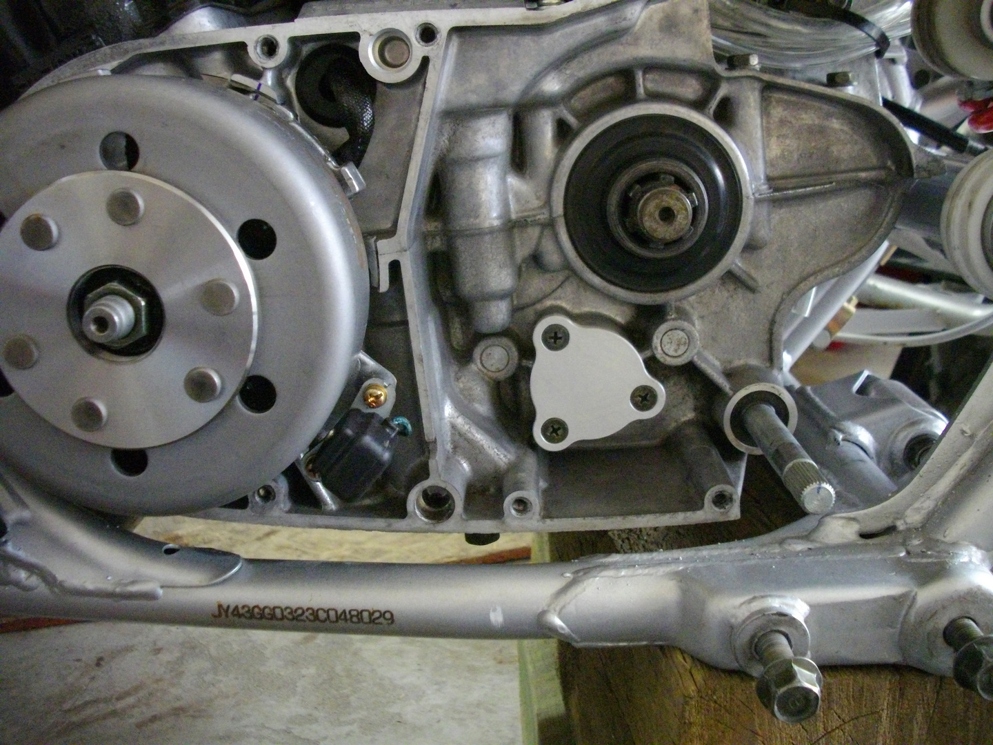

installed the first piece of bling today :excitement:. matoon nuetral switch cover. the stock plastic one was cracked. not even sure what the hek the cover is for but i didnt see any point in using another plastic one. im really liking this machine even though i havent rode it much yet. mostly just been cleaning everything up and inspecting stuff. went through all the linkage to be sure it in good shape and greased. pulled out the reed blocks and checked pistons for cracks etc. cooling system must of had the original stuff so i got that all cleaned out. probly get a timing plate, clutch and flywheel covers next. straight cuts, 8 plate basket and lockup probly be after that. leaning toward a lonestar chassis also but that might be more around spring time
