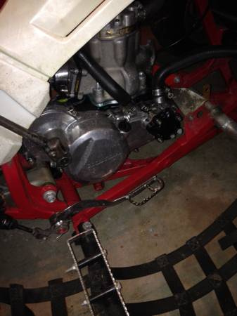

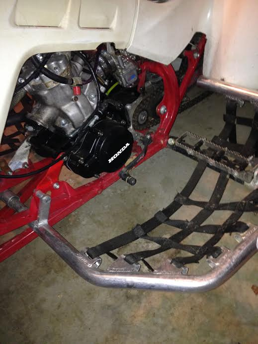

I just stumbled on this site yesterday and promptly joined. I've been searching for a good 250r for about 4 months now but haven't found what I want yet. Going to look at 2 different 250r's tomorrow and I have a question about one. The owner says it's an '88 frame but he wasn't sure if the motor was an '87, '88 or '88. Just thought I'd post a few pics to see what you guys can tell me before I go to check this thing out tomorrow.

i think i see the 88-89 cases. What does he say is done to the engine? 86 piston by chance? or a 4mil stroker?!?! Those are OEM plastics though!

Thanks for the feedback thus far guys. The motor is fresh off a rebuild, haven't gotten in to the nitty gritty details of motor work, we talked over the phone earlier this week and he spouted off a bunch of stuff that it had me slightly overwhelmed. Says it just needs to be tuned so that the jetting is just right. Has elka stage 3's, lone star axel, beadlocks, etc.

I see a spacer plate, and as pinned commented, this would indicate either a 4mil stroker or the use of a short rod piston.  If I remember right, the only time one would use a short rod piston on a long rod motor is when the bore size gets above 68mm.
Also, not sure what that regulator/needle valve is hanging down on the left size, I don't know what that would be for.

I have confirmed that the motor contains a long rod with an '86 piston, not a stroker.

a question for the guys more familiar with these engines. wouldnt a short rod piston on a long rod indicate the cylinder is about shot or no ?  i hardly have a clue about these 250r but im learning as well

While studying up on these machines I've noticed a lot of guys running the long rod crank with an '86 piston. I believe it requires a 3.5mm spacer plate. But I'll let the experts confirm.

well what i was refering to is the '86 piston in a later year cylinder. you didnt mention the piston size but i was thinking this may or may not indicate they have exceeded all the available piston sizes for that cylinder and went to the '86 piston to get a couple extra bores before it needs a resleeve. hence my comment that it might be on borrowed time. then again it might be a fairly new cylinder and they used '86 piston for other reasons

Good pt, I hadn't thought about that. Glad you mentioned, I'll def get him to explain the reason for the setup. Hopefully the rest of the quad looks and sounds good.

86 piston is generally accepted as the better piston for performance because of the large intake cutaway instead of the full skirt piston on the 87-89
