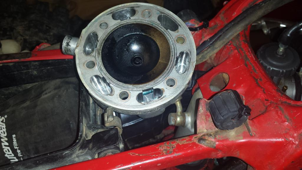

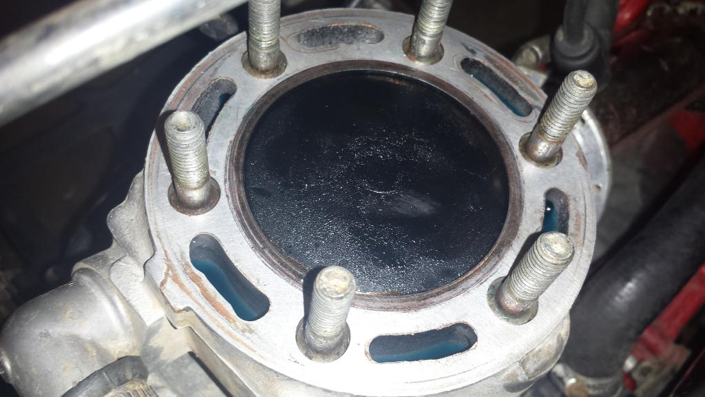

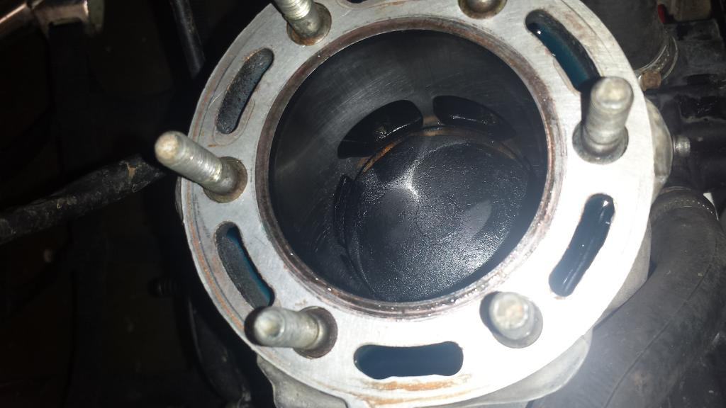

Here's an update...Took the head off and confirmed the coolhead dome has  a 22 stamped on the side of it.  I snapped a couple of photos of my  head and also piston crown, any comments about the build up/crust on  both?
So if my math is correct, my original squish was .090 (measured with a  piece of solder) using the 3 piece head gasket.  If I separate the  gasket and use the 2 outsides I lose .040 from my squish, leaving me  with a .050 squish...Am I safe to run no ethanol 93oct with my 22cc  dome?
Thanks for the help!

Having read my entire situation, what is your take on it?  Also, what's your opinion on the buildup on the piston top and also the inside the dome?
Considering stock porting and the desire to run pump gas(as well as my other measurements), am I wasting my time trying to improve upon what I have by having a new dome made?
My current dome's squish width is 10mm, I'm assuming that is standard on 22cc cool head domes, but from what I've read seems a bit narrow for my preferred application.
