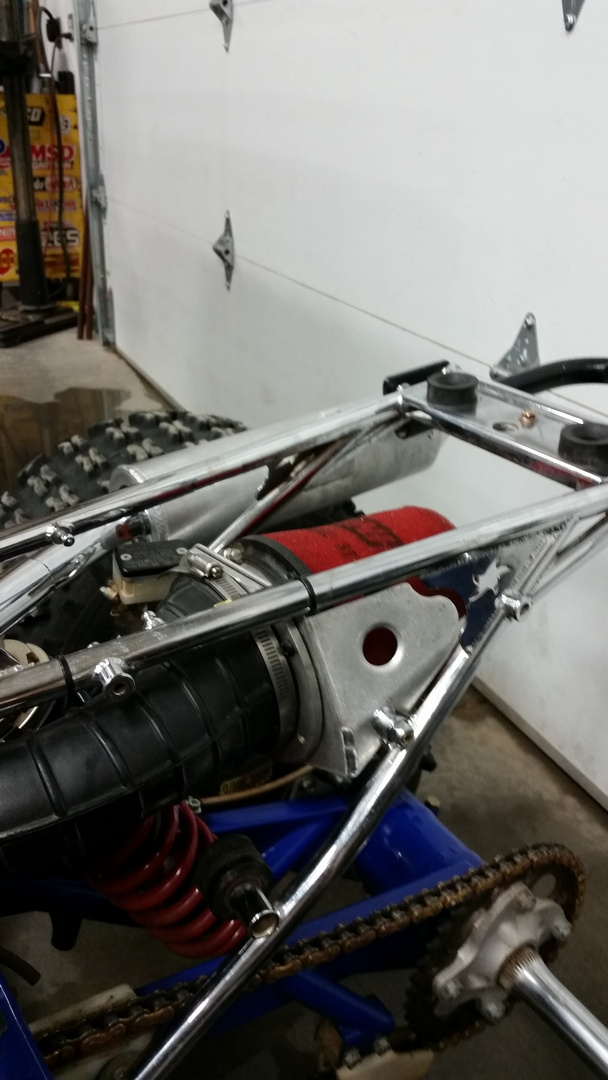

I'd like to see some pics of your intake. How did you end up clearing the shock. What boot?

If you look at page 4 of my thread over on ATV Riders, I have a couple pics of the intake. The Pro Tect airbox is designed to use the oem boot, it comes with a piece of metal tubing and hose so you can get to the carb. The only difference between then and now is I had to move the box back a couple of inches, so the piece of tubing is a bit longer. I had to move it back because if I didn't the shock would have rubbed on the boot. Of course, moving it back meant I was going to have issues with the caliper and swingarm hitting the airbox. As I said, it works, but not really happy with it. One of these days I plan on having a fab shop build me a custom setup, but that will probably be a while down the road.

Just looked through my thread over at ATV Riders, page 6 has pics of the current intake setup. Took those after I had the fab shop work on the box.

I too wasn't very impressed with the Pro-Tect airbox.
The intake boot had to be trimmed to fit in between the airbox flange and the top plate, and there's very little clearance on the filter flange at the bottom of the box. My filter fell off because it never was on all the way.
