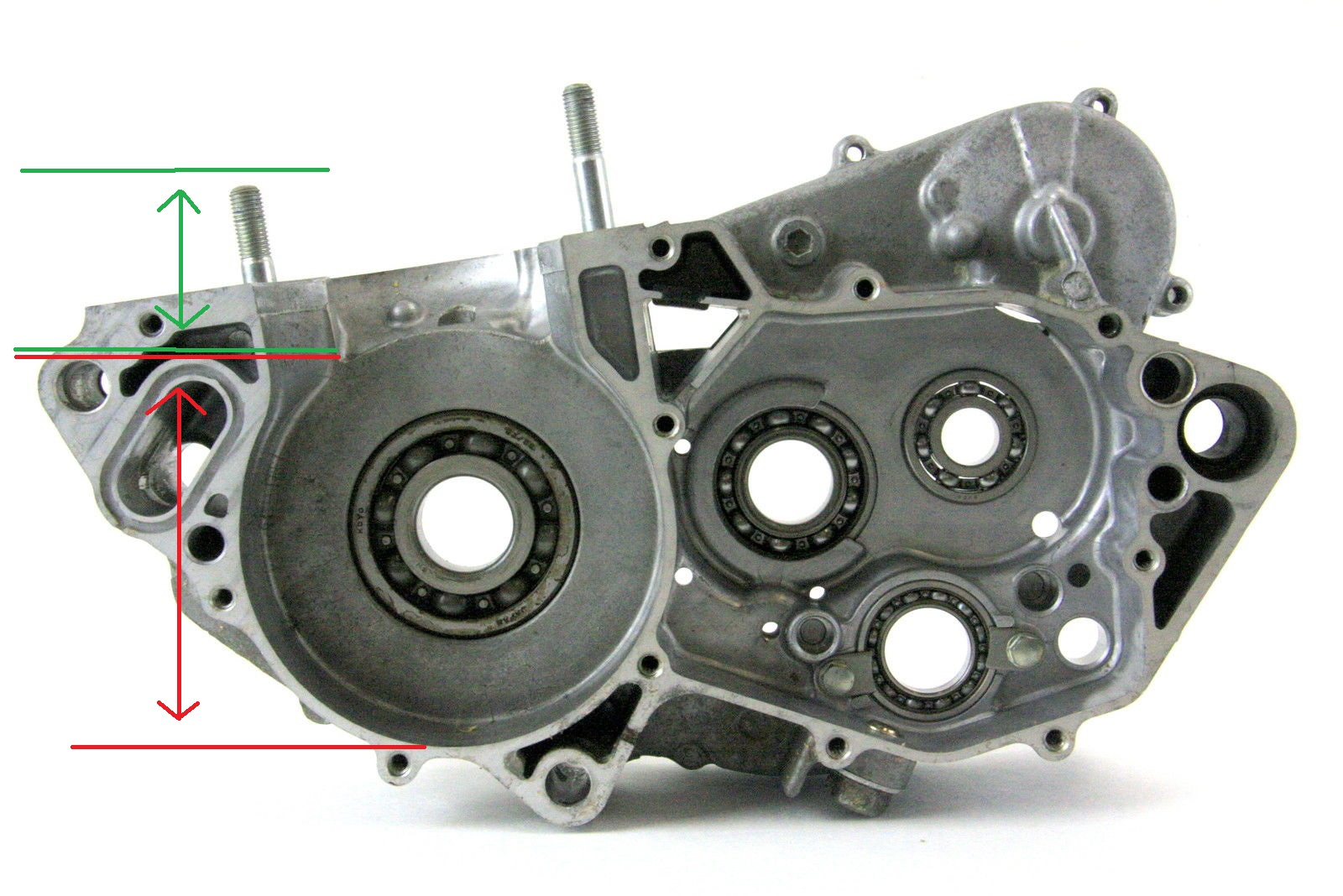

yes it will increase the volume but i dont think thats the issue here.  where the extra volume is located might be what you want to consider. with the tins gone it puts all that volume down low into the crankcase.  i would take a guess and say thats not the best place for any extra volume. most crankshafts ive seen use tins or some other kind of plastic stuffers, i believe its not to reduce the overall case volume like most people think but rather to put the volume up higher. in this pic your volume increase will be more between the red arrows section. i think you would be better off with it in the green area instead. for example if you were to put the tins back on and use a longer rod it would put your volume more in the green section. not sure what anyone else thinks but thats what makes the most sense to me anyways

Quote from: 85drag250r;43213
FYI, volume inside an engine is just that...volume. It is not divided into sections.
  if theres very little space in the lower crank area for the mixture to occupy then it has no choice but to occupy the upper area. how can it occupy a space that doesnt exist ?  with the tins in place, that extra space doesnt exist anymore

IMO if you are purposely adding volume to a crankcase, adding it to the lower crank area is not the best area, adding volume under the the cylinder transfer ports will shorten the path to the cylinder.
