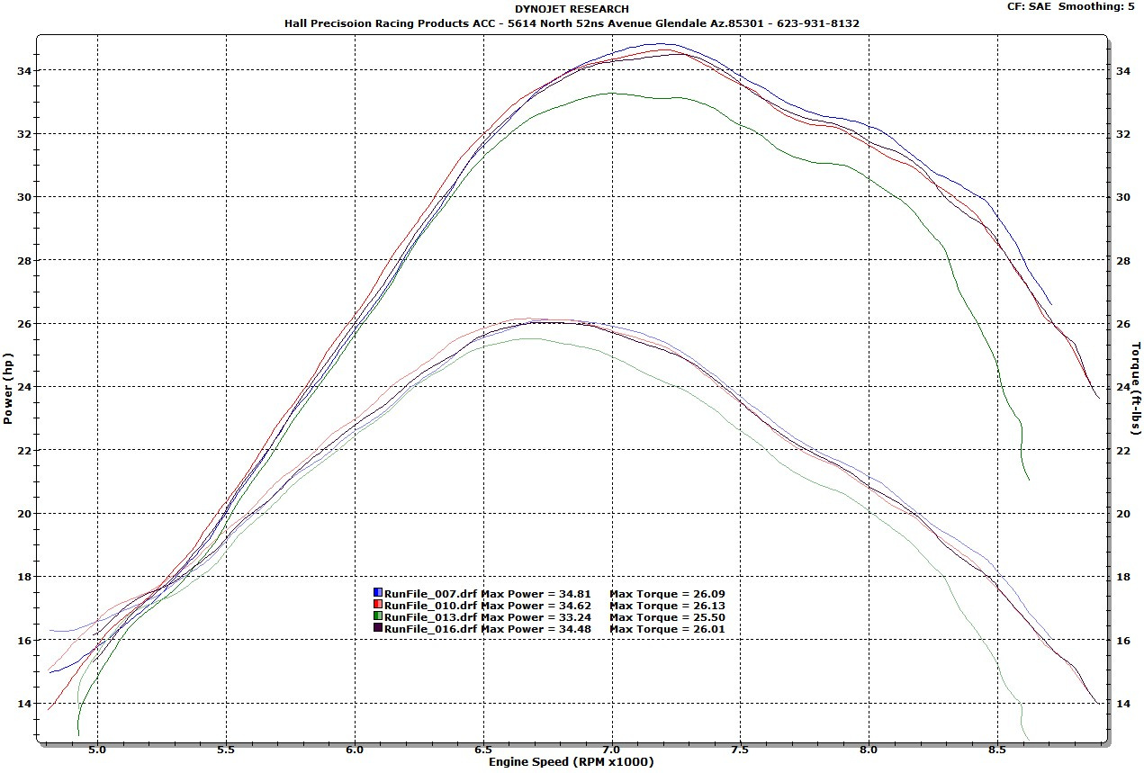

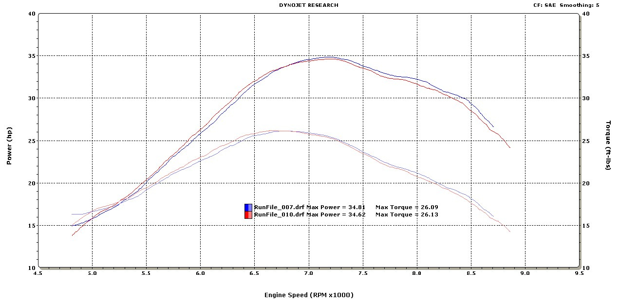

« Reply #89 on: October 21, 2014, 09:54:23 PM »
I started looking for some dyno runs as examples to some of the situations I have been talking about.  This may take a while to find exact examples because the dyno this computer is hooked up to has over  22,000 dyno runs on it and I have four dynos with their own computers and dyno runs.  I have not tried to import files or pictures to this site so I may need some help displaying the information.
The first group of runs I want to post shows the effect of having a main jet that is rich (run 013) but not rich enough to miss-fire at the extreme high rpm range.  There are a couple of runs that are a little rich (run 010, 016) and a run (run 007) that has the main jet for max power.  This engine is in a very mild state of tune and very forgiving on its response to different main jets.
Make note that the front side of the curve in the 5000 to 6500 range is not affected very much by being a little rich.  Having the mixture correct after the torque peak tends to produce the most peak power and better power after the torque peak allowing the engine to make the best power over the widest rpm range.  These curves are not exactly what I was looking for but are a close approximation to the situation described in tuning state #1 above.
If we look closely the 178 main jet produces the best power in the 5000 to 6750 range and the 170 main jet produces the most peak and the best over run power. A carburetor with an adjustable air correction jet could probably be tuned so that one main jet with the proper air correction jet could produce a power curve that would give the front side of the curve of the 178 main jet and the power after the torque peak that the 170 main jet produced with the 39PWK.
Click on this:  It gives the run number, jet size and line color.  I am sorry the lines of the graph are so skinny and pale, it makes it difficult to see the distinct line colors.
