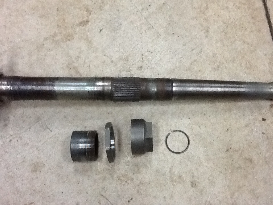

so I just attempted to take apart my rear ends and may have stumbled on something. it appears that the nut threaded all the way out to the wheel side of the threads, and when I try to spin it, it moves, but then gets real tight. I put more muscle into it and it popped and it was loose again, but the nut does not move no matter how much I spin it, so im guessing this thing is stripped/cross threaded. may this be my issue?

That nut tightens up to a circle clip that direction, if you screw it the opposite direction you can remove that circle clip and all that stuff slides off.  I tried to explain that in my previous post...Somewhere on the web is a PDF of the Honda service manual, you should check it out.

The axle nut has left hand threads so push down on the wrench to loosen it, both nuts tighten towards the wheel. If it's popping it's probably rusty, try pb blaster or liquid wrench, or wd40 if you don't have penetrating oil. Here's an exploded view:
