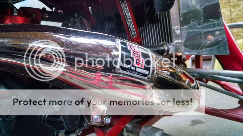

it had some goodies to say the least!!
I forgot about the brand new CBR radiator

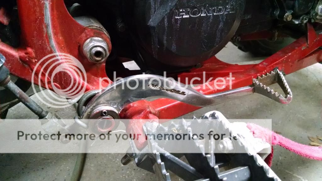

                                                                                                                                           I bought a set of Rath 450r nerfs with heel guards.  These things are made real well. I was surprised about the quality. Very  nice for sure. They took a little more work than I expected to get  fitted but was all good in the end. dont mind the crappy white PC. that will all be taken care of!
I cut off the existing peg mount
Offline dem3500
88 XC my first trx250r
« Reply #7 on: December 27, 2014, 07:25:20 PM »
                                1" od tube is what would fit in the nerfs. I ended up grabbing  some 3/4" black pipe from the hardware store. It was a little bit bigger  than 1" but some time with the flapper wheel I got it down so it would  fit the nerfs. Getting it to fit through the frame was a little bit  harder. There's a reinforcing sleeve inside on both side. (im sure most of you all know this already lol....im new! leave me alone haha) All I did was  spend some time with the die grinder so I could slide the pipe through.  Not difficult but took a bit of time to finish.
Offline dem3500
« Reply #8 on: December 27, 2014, 07:27:01 PM »
A pic of the sleeve on the left side. The right side sleeve was a little bit deeper.
