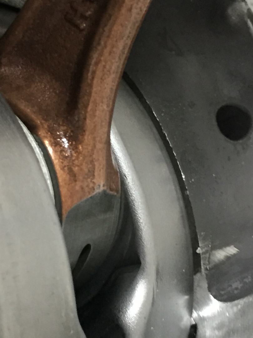

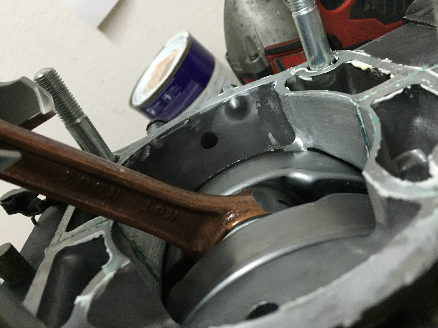

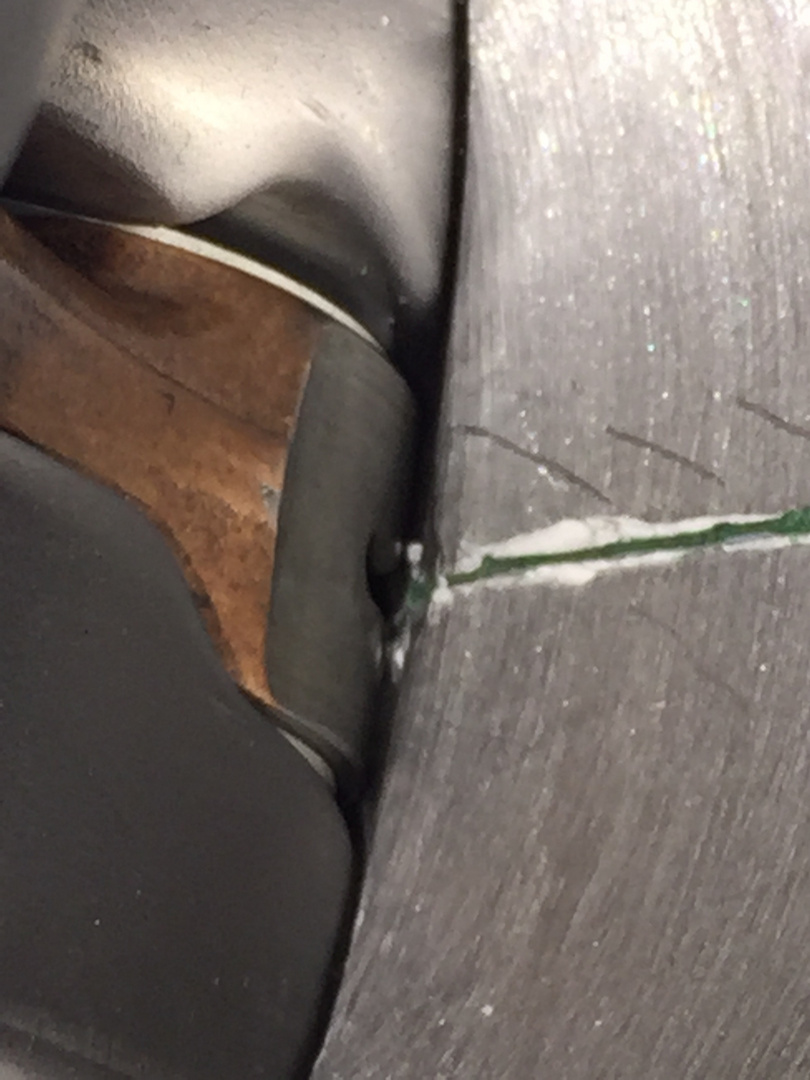

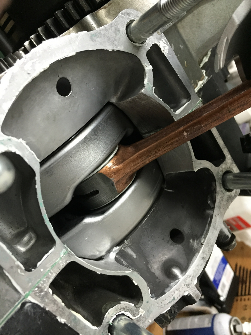

« Reply #24 on: January 13, 2015, 09:05:15 AM »
Here are some pics of the culprit crank rod and machining. If you look closely, you can see the high point of material they left on the crank rod that is causing it not to clear correctly. If they would have smoothed out the transition on the rod just a little more, the crank would have cleared like it was designed to. It is possible that this is just a machining error. Perhaps the cnc program was not set to transition enough of the material off. I still haven't heard anything back from Hot Rods yet.
