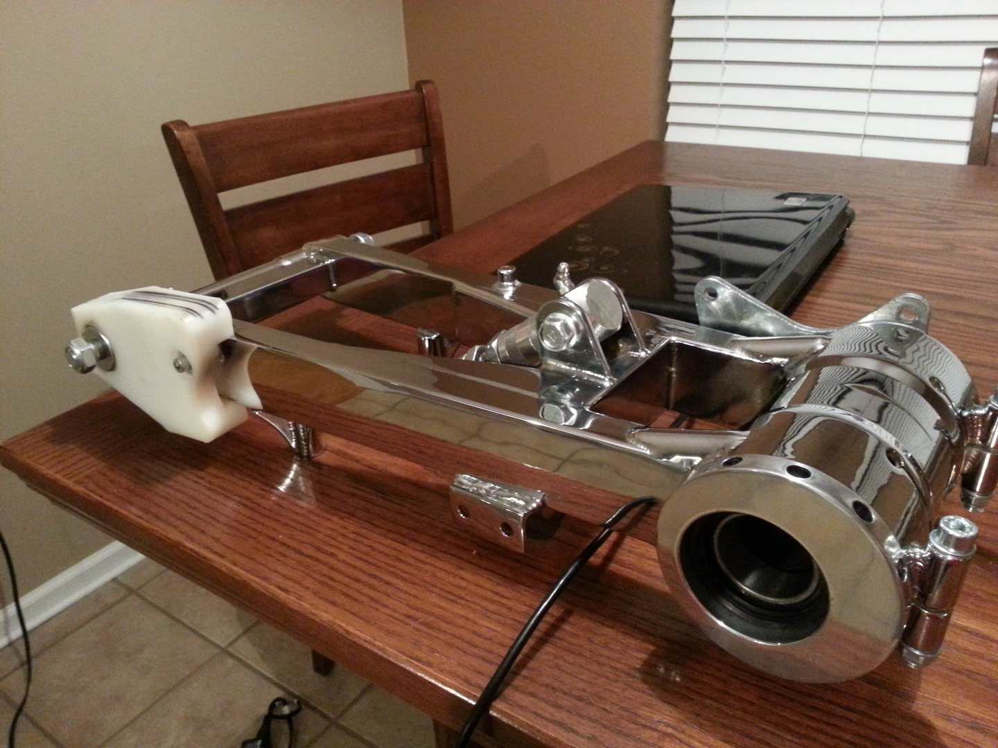

Got the bearings in the swing arm and linkage. Just waiting on the lonestar frame.
Nice!  I wish I had a new Lonestar frame.  Did you buy that swingarm off Ebay?  There was one on there for a good price.......was tempting.

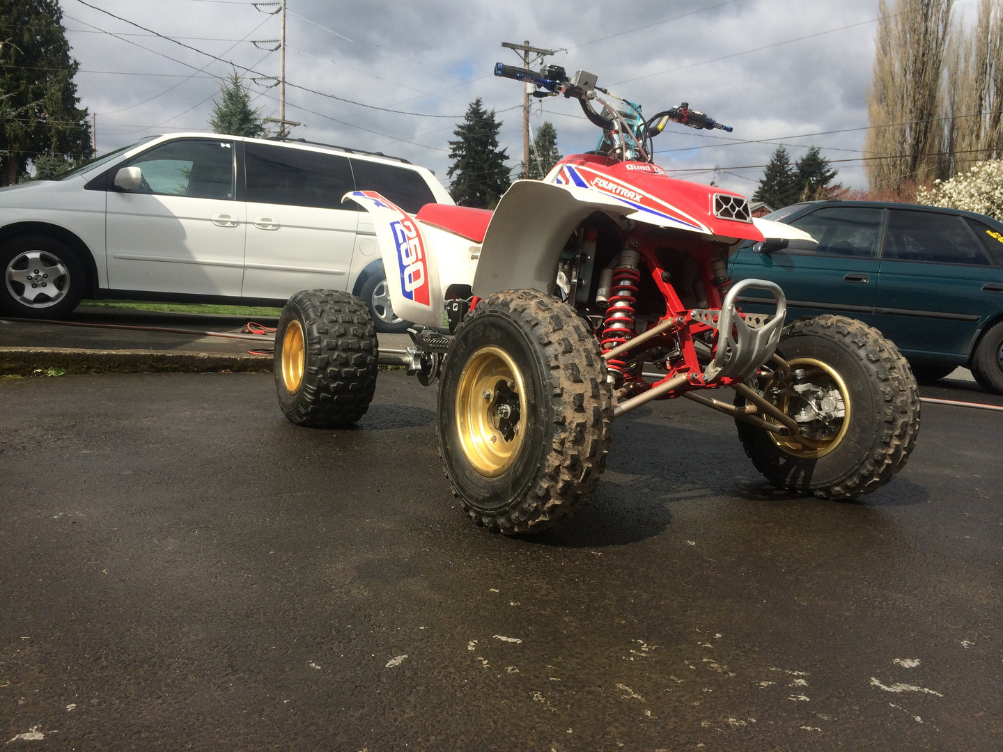

E
Got some oem front wheels finally!!! Sooo pumped

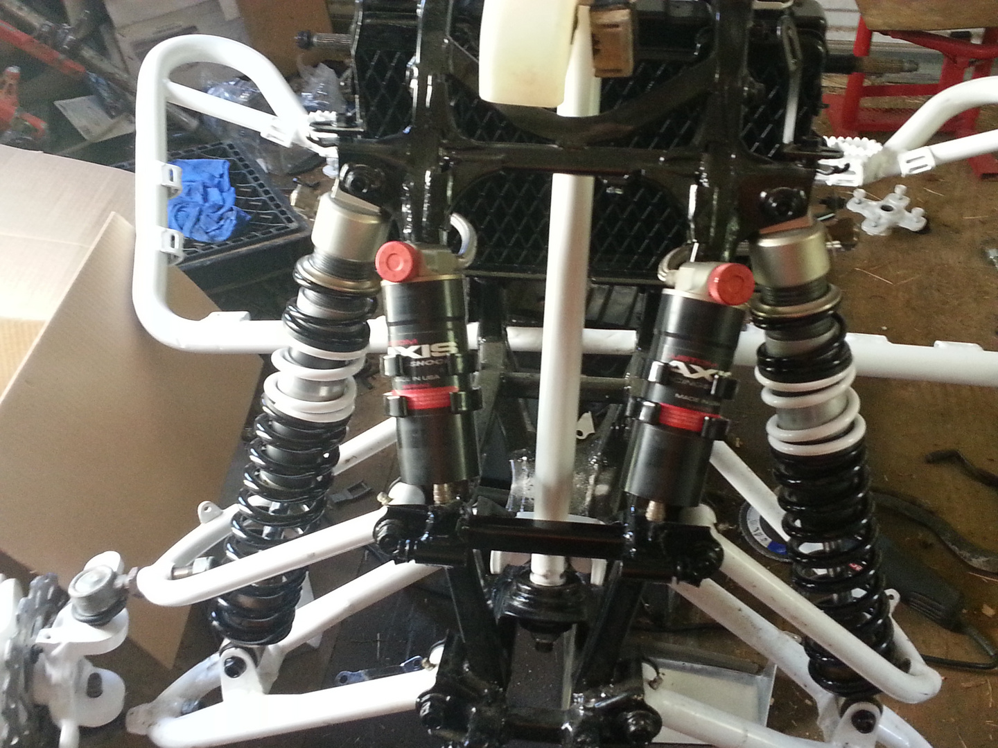

Got my shocks onfinally.
