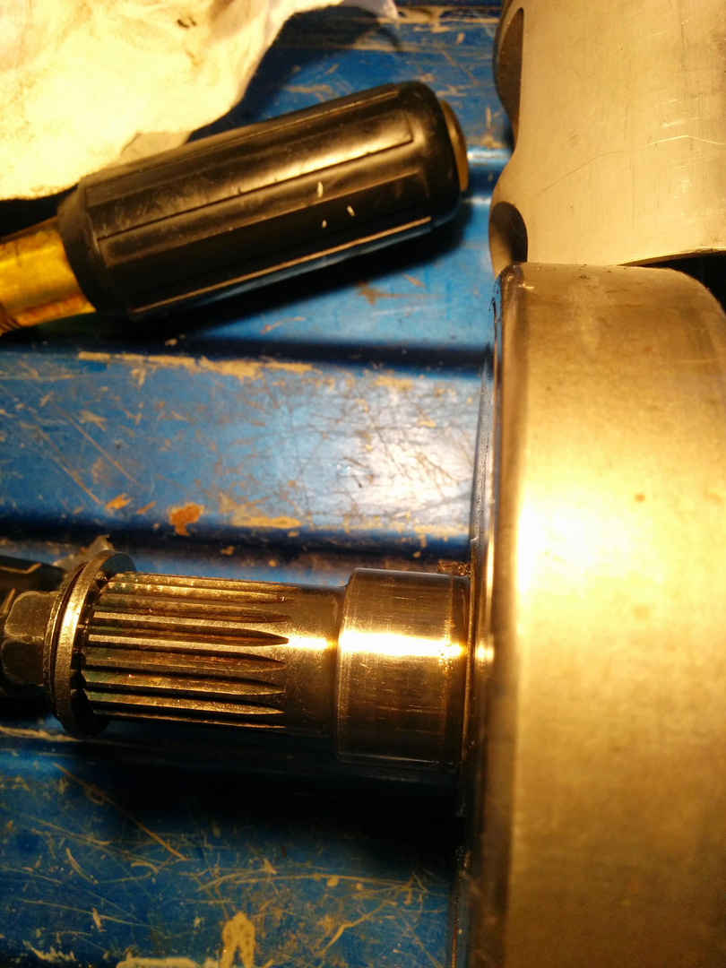

Heres a bunch pics. You can see some wear on the crank where the bearing goes. Any hope for this?

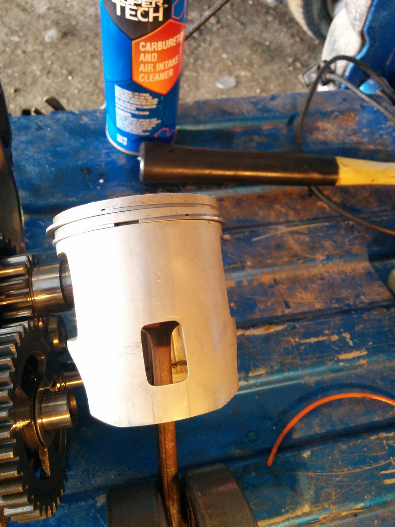

The piston looks like a stock size, there would be a marking on it if it had been bored right?

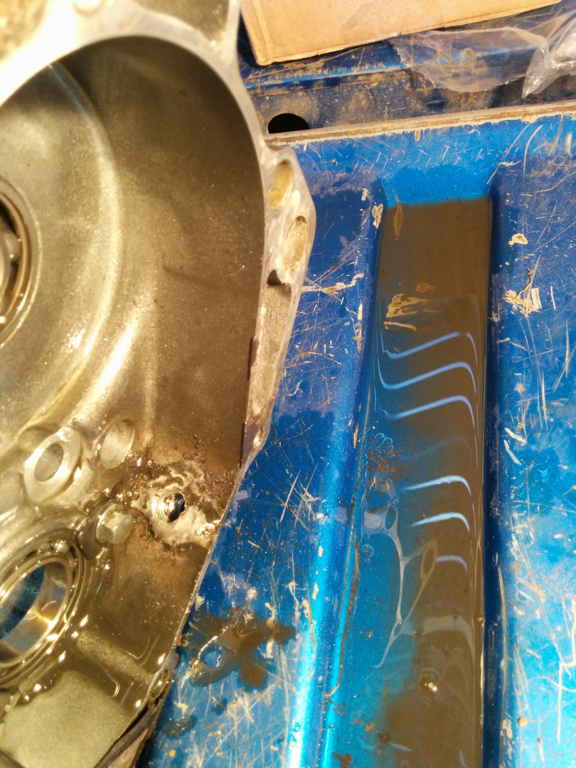

In the last pic it looks like they stripped the threads for the drain plug and is that some form of liquid thread fix or did they weld it?

Measure the shafts on the crank to see if they are worn or out of tolerance. Pretty sure the right side bearing is a slip fit, left should be an intereference fit. Rough bearings will absolulely give it end play.
Usually there are stamped markings on top of the piston. You can clean the carbon off to to verify.
Hard to see the drain hole, the picture is small on my tablet. The best is to have it kingserted or like. I have ran helicoil solutions on cases without issue, but that is not as good as some of the other insertable threads. Welding is also a solution, but not as insertable threads in my opinion. Welding the cases can be expensive, it will deform them (so they need to be flat plated or machined on the mating surfaces) and it will anneal the aluminum in that area making it a little bit weaker.

I cant find the tolerance in the Honda Service Manual I have. Anyone know what it is?
I have 1.100 and looking at a new bearing it specs out as 28MM which is 1.10236. I would think 2 to 4 thousandths of an inch might be a problem for a crank.
I wonder if there is some sort of loctite that I could use to put it together. I have known people that brazed/bronzed shafts that were in pretty bad shape and it worked. This is different though and I want to do it right also. Anyone have a new bearing they could measure the ID?
The threads are ok but it looks like it had been repaired at some point.
I couldn't find any markings so it must be a stock size. Thats one good thing at least!

You have almost no way in telling how many hours are on that crank. If the crank is so worn that there is play between the bearing, then it's time for a new crank. The rod on an OEM crank can be rebuilt but not the surface I think you're referring to.
You're best bet would be to get a new crank. Spend the money and do the work now before the crank blows through your cases. It's worth the peace of mind
Low compression, whats next?
« Reply #25 on: March 02, 2015, 07:22:14 PM »
They can build that surface back up with flame spraying but is it worth the money probably not with how cheap a hot rods crank is.
