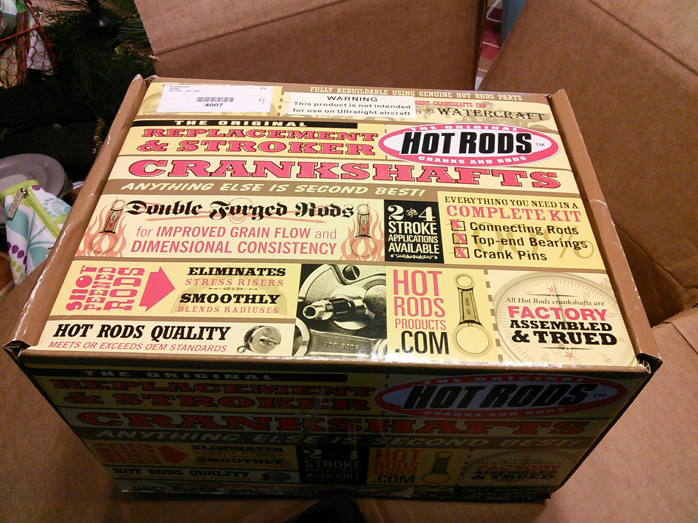

I will give Toledo Honda a try, that is where I ordered my water pump off of Ebay. I did end up ordering a crank off Amazon yesterday but I called the 3rd party and made sure the crank was a newer production. They said their stock was out in Nov. and everything was ordered from the factory since then so I should be good. It came in the yellow box which I was told was the better one so I should be good. It was something like $202 so thats even better.
They were only a state away in IA, pretty nice when it comes in 1 day.
