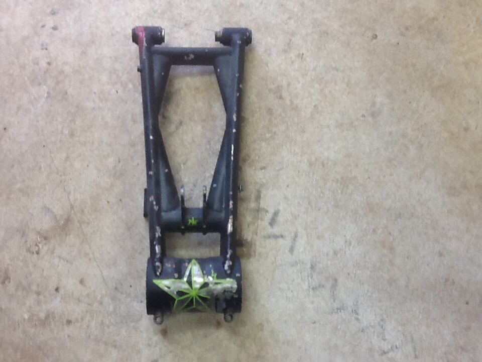

Offline Jimbo45
Streamline 3 pc front braided set - location of "tee"
« Reply #8 on: March 18, 2015, 10:04:35 AM »
Quote from: 87cclR;51746
Please do, I'd appreciate it.
Gonna go pull it out here in a bit, and will try to get a pic for you.
Offline Jimbo45
« Reply #9 on: March 18, 2015, 11:08:43 AM »
Mine appears to have just bolted on to an existing bung.  Not sure it that was added or is stock though....
« Reply #11 on: March 18, 2015, 11:19:43 AM »
Those two bosses on Jimbo's pics are the factory locations for the stock brake lines.
Offline Jimbo45
« Reply #12 on: March 18, 2015, 11:23:57 AM »
Quote from: 87cclR;51751
Sweet, thanks for the pics. I'll post mine once it's done.
No problem.  Will yours not simply mount up like mine?
Offline Jimbo45
« Reply #13 on: March 18, 2015, 11:24:53 AM »
Quote from: rablack21;51752
I figured so, but wasn't sure what was done to this frame before I had it.
« Reply #14 on: March 18, 2015, 11:27:38 AM »
Quote from: Jimbo45;51754
And some of those things change from year to year. The 88-89 same mounting area is different from the 86-87.
