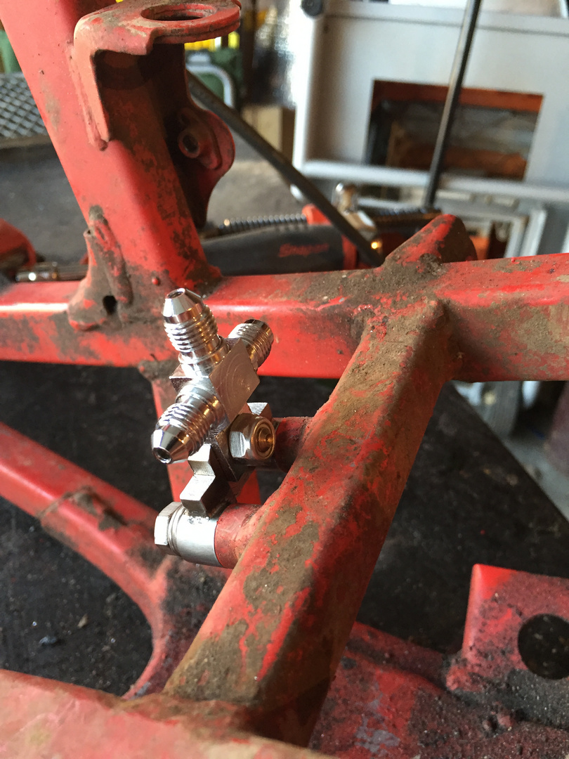

Some more work done, little by little. Made a bracket for the tee that came with the Streamline kit, uses the existing bosses. With the plastic screen removed from the radiator it clears perfectly.

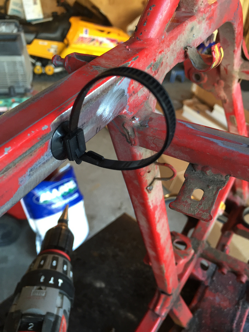

Test-fitting a sacrificial automotive-style mounted tie wrap. They're the simple little bayonet style ones that push in and are a pain in the ass to get back out - won't be reusing this one. Made the time spent cutting the tabs well worth it, as the wiring will be almost completely hidden.

« Reply #6 on: March 31, 2015, 08:10:33 PM »
Looks great and a great idea for the wiring

Quote from: 87cclR;52462
Real important is you check to see if your pipe clears the bracket you made. Have had this problem many times with the pipe hitting the bracket I made to hold the brake lines

D'oh! The pipe! Spaced that off, haha!!! Will update on the bracket in a few months....

« Reply #10 on: March 31, 2015, 09:03:23 PM »
Why not just grind the corners and drop the bracket down?

Quote from: Skeans1;52463
Thank you. Found those on Amazon, package of 10 for a whopping six bucks. Dare I say, score?

Quote from: Skeans1;52468
I wanted the outputs of the tee to be at approximately the same height as before, so they'd feed right into the calipers across the top of the upper arms. If I have to, I can rework this one or start from scratch after the pipe comes and I test-fit it. The bracket is two pieces of .500" OD stainless with 6.5mm holes, machined to .375" thick. I then machined the holder and TIG welded it to the rounds. Worst case, I have to re-engineer another. Here's to hoping though.....
Here it is, the humble build by 87cclR
« Reply #13 on: March 31, 2015, 10:06:06 PM »
I tried 1/8" thick stainless spacing it straight up 1". Pipe still hit. I proly gonna drill through the frame and mount from the other side.
« Reply #14 on: March 31, 2015, 10:13:36 PM »
I've done this with jic fittings is put a bracket around the top fitting for a hanging effect
