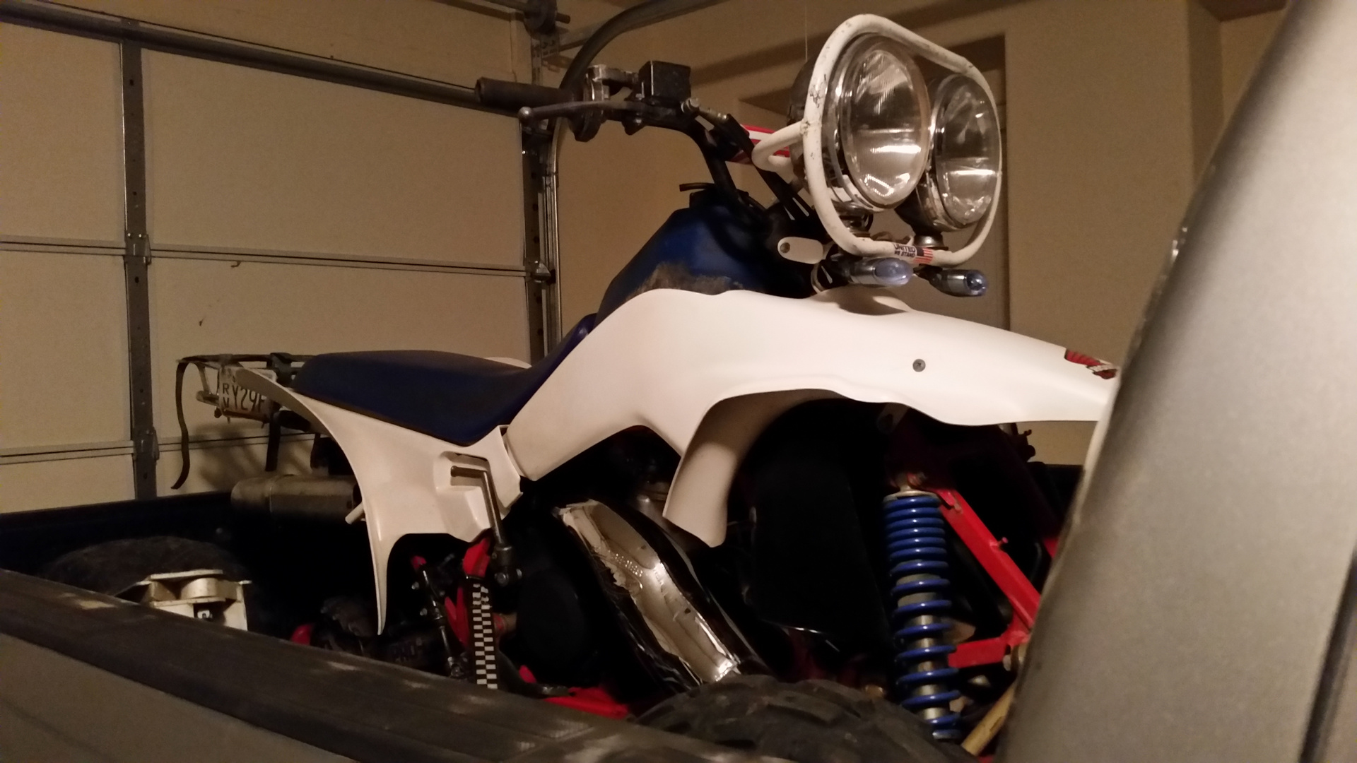

« Reply #5 on: March 25, 2015, 12:24:21 PM »
Its kinda tough to see because of the hand guards, so i posted the other pick .  IT looks like its supposed to be that way.

« Reply #6 on: March 25, 2015, 01:03:11 PM »
Looks normal id say. Are those handguards moose? Not attractive but you can see they do their job lol

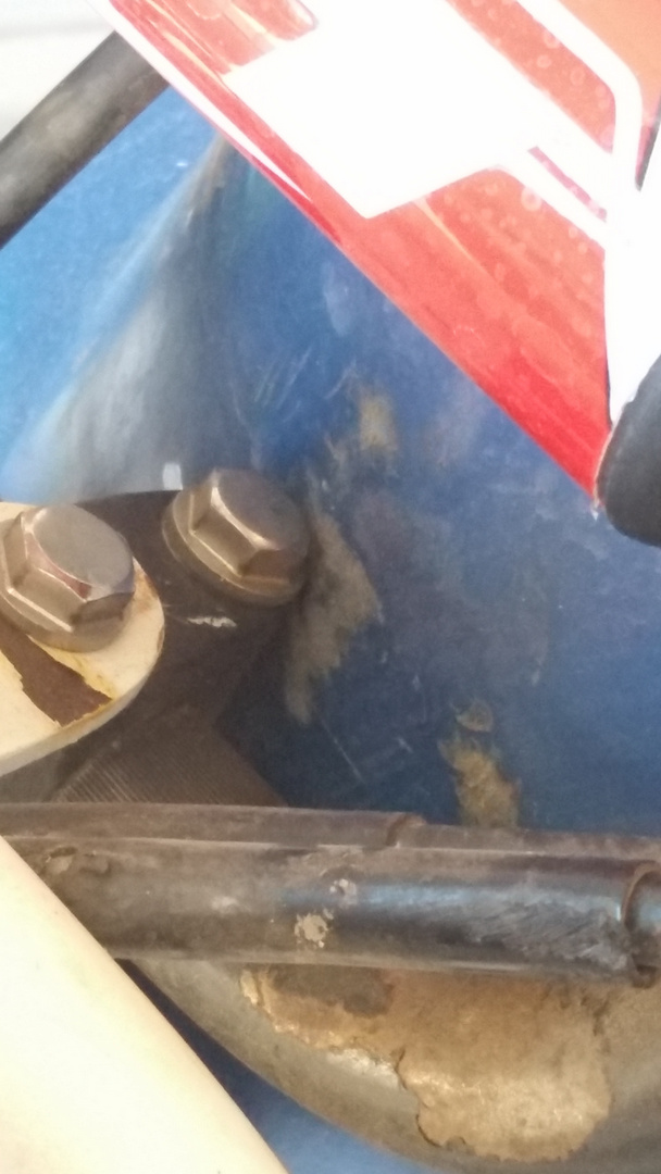

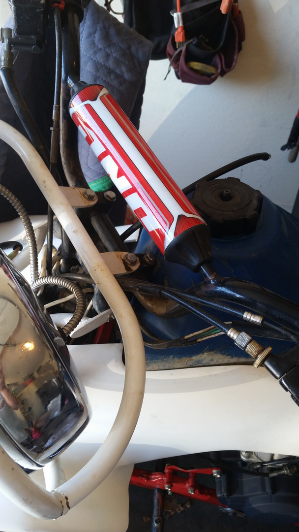

I have an IMS 3.6, says trx-1 on the bottom.  I don't have any problems with it as far as fit and comfort go.  It took a while for me to accept the aesthetics of the thing.  When I first put it on I thought it stuck out like an extra foot- now I hardly notice the extra height and I don't worry about my fuel level anymore.  I would rather drain a wasted gallon on premix after a ride then worry about running out in the middle of the desert lol.  As you can see from the last pic it rubs on the bars but only at the terminal end of its radius and doesn't affect my turning ability.

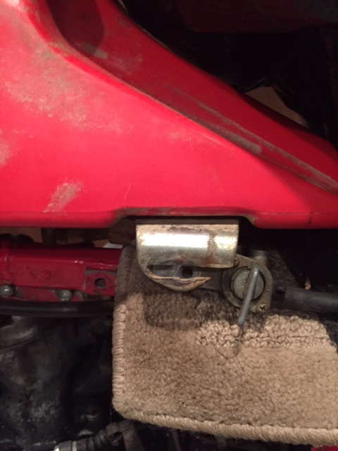

« Reply #10 on: March 26, 2015, 02:37:14 AM »
you could always slot the rear tank mounts some to allow you to move the tank further back.  someone butchered these bad (don't have to make the slot too wide) but you get the idea.  I personally would have milled the slot to make it look more professional
