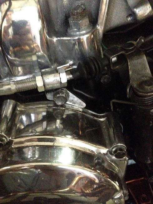

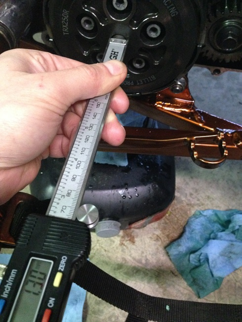

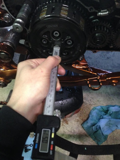

Here is a before and after measurement of adjusting the clutch arm using the clutch cable adjustments on the left side of the cylinder.
First one is with what my previous clutch arm adjustment was set at for the stock clutch plate and spring setup
This is after adjusting the clutch arm, unfortunately the adjuster is on its last thread so I will be using either a thicker washer or two washers so I dont have to use the last threads of my clutch cable adjustments
And again here is what my clutch cable adjuster looks like

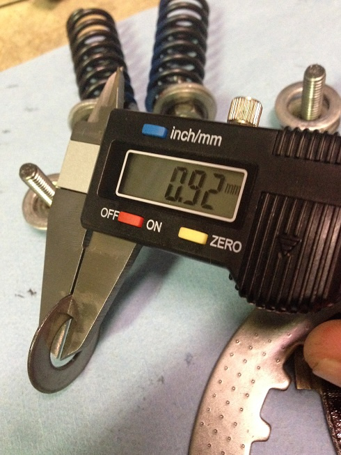

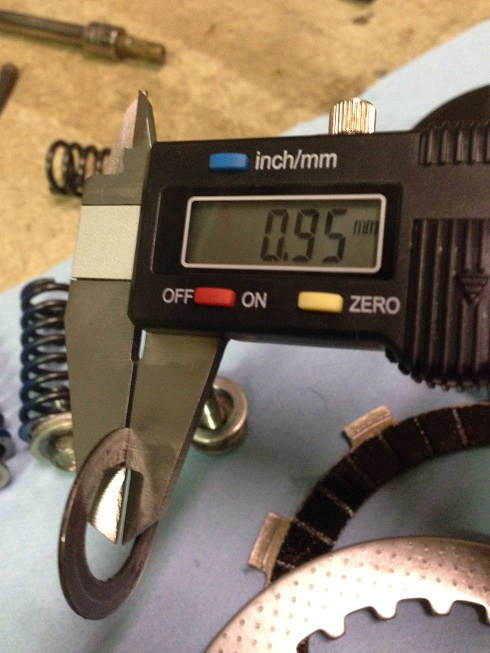

Here are some measurements of the washers I used
The first is the '89 washer that came with my Hinson pressure plate
The second is one that came off one of the older year pressure plates...not sure which, It is a little bit bigger
I'm going to find a washer the same size as the '89 so it doesn't sit off-center of the clutch lifter because its so much bigger.

That second washer pictured looks like the one that goes behind the locking/tab washer that holds the inner hub on. Its way to wide to go in the pressure plate for the lifter bearing.
