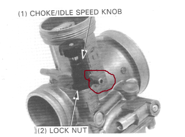

I did a little work on the carb and am just getting frustrated. I really question if this is the right carb. I have 2 floats that came with my R and one I bought new and something just isnt working right. I am seriously thinking about just getting a new carb. I can get a 38MM Air Striker for 203 or a 35MM for 184. I think it might be a good investment. What else would I need? New throttle cable?
I have also thought about just getting a new PJ, they are cheaper. I can get this one for just under 140.
http://www.amazon.com/Keihin-016-039-PJ-34mm-Carburetor/dp/B00C178IZ4/ref=sr_1_1?ie=UTF8&qid=1428933656&sr=8-1&keywords=keihin+pj+34
I need to get the choke/idle speed knob anyways and they are 30 bucks right there.
