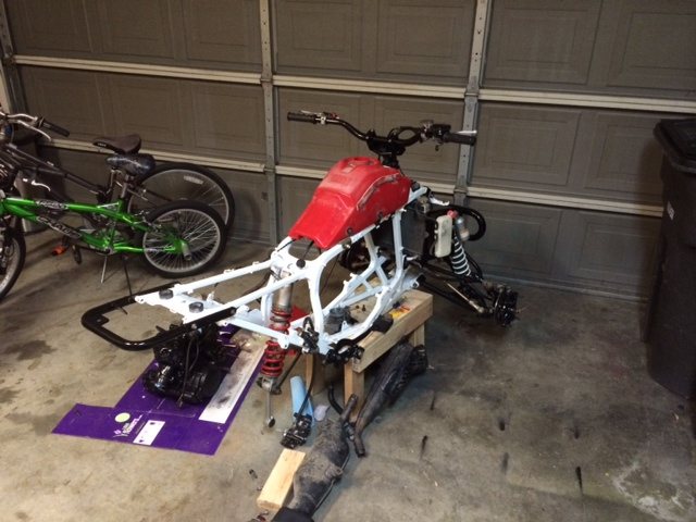

Skipping forward a bit, I found a bunch more issues...  this was a cool discovery.
Carrier hamburger!
This is the point I decided it wasn't worth it to not do a frame up.  Admittedly, 50% of the reason was because it's purple. I think I threw up in my mouth a little everytime I looked at it. So, it exploded onto my shop floor one evening.

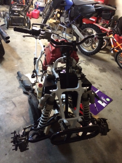

« Reply #8 on: April 27, 2015, 07:34:36 PM »

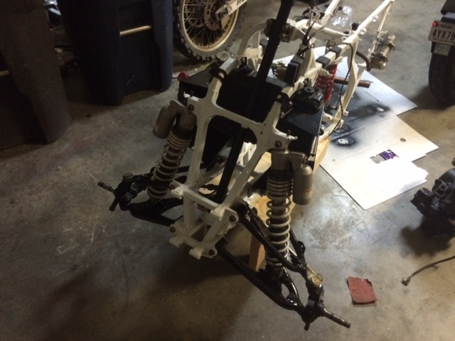

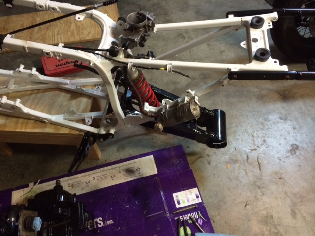

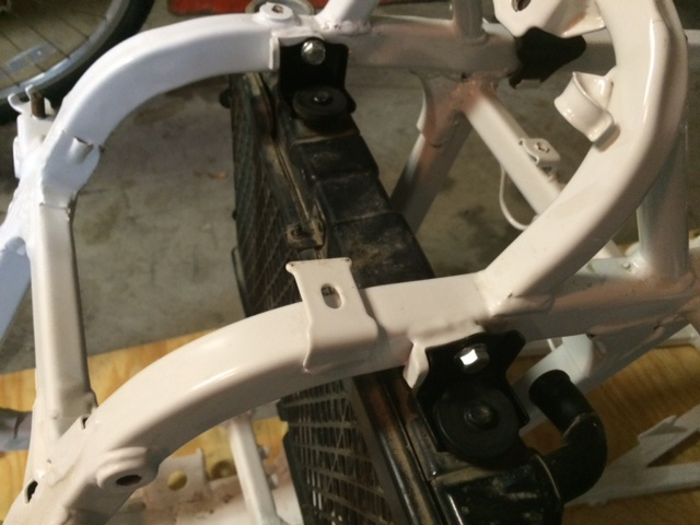

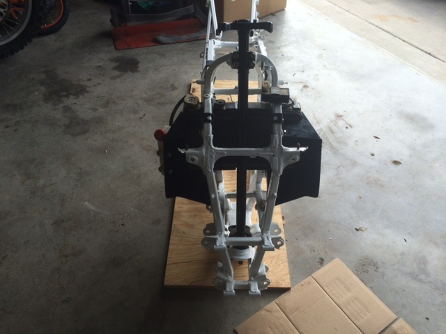

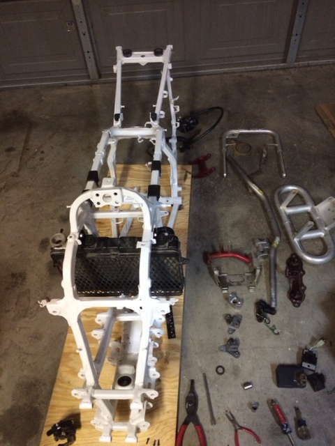

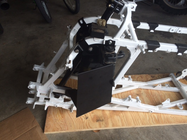

Started whipping up chassis gussets
Stitch welded it in, mostly because my helmet was so dirty I was flying blind.
Offline Tador
87' R project
« Reply #10 on: April 27, 2015, 07:48:19 PM »
After I finished the swing arm gussets, I found new lenses for my helmet. I put them in before making the sub frame gussets... and it was like a miracle!
Offline Tador
87' R project
« Reply #11 on: April 27, 2015, 07:49:19 PM »
Finising up the subframe, and adding the motor mount gussets.

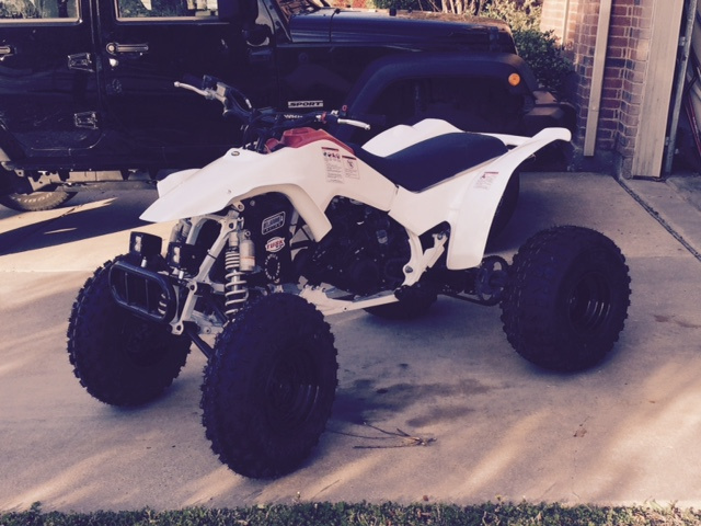

« Reply #13 on: April 27, 2015, 08:08:09 PM »
The fun part!
