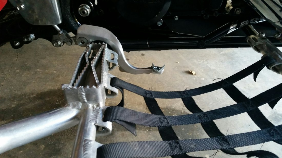

My Laeger frame uses one but I have it all mounted up and it's hitting the propeg. Has anyone ran into this problem? Can you adjust the rear m/c shaft to make it longer? That might put the clevis lower raising the pedal if it can.

looks liek the way its hanging way down, the brake MC rod just needs to be way longer

My Crf is the same way...ended up havin to file some off the pedal :( what rear MC are u using?

I agree Jesse. I guess I'll be looking at doing what you did with the crf m/c. Ryano, I'm using the trx one right now.

You should have a little bit of adjustment at the clevis. I had a similar issue with alignment using a trx mc. I used a banshee clevis, which is a bit longer. You can find some different clevises on McMaster Carr's website also.

Thanks Jason I'll check out the Banshee clevis today at work. I do have a little bit of adjustment left at the clevis so I guess it will take some playing around with. Nothing like a custom build!

A coupling nut and a short piece of threaded rod should do the trick.

The banshee clevis pin is slightly larger diameter than the trx.  I had to drill the hole on the pedal to make it work.

I ended up lowering the R clevis down a bit and did a little tweaking on the pedal. It's just about perfect but eventually I'll use a longer clevis. Thanks for everyone's help.
