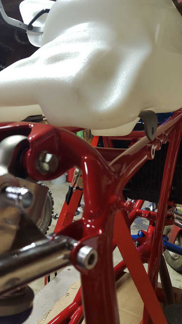

So my 4.0 gallon IMS tank hits the upper shock mount support bar. Has anybody used a heat gun to mold a tank to fit? Or any other similar situation? I'm afraid of putting a small hole in it
It really doesn't have to move much to be able to fit

Does the stock tank fit? I didn't realize the 4 gal IMS was longer in the back. I tried to form the bottom of a 3.6 without much success. That was in the middle of the bottom. I think what you want to do there would be impossible. I hate that word. I have had success expanding the thinner parts on top. Can you go in front of the shock hoop? I did watch someone burn a hole in a brand new tank with a torch.

The stock tank fits, which frustrates me. I bought this IMS tank only a few months ago not knowing i'd have this problem. The IMS is longer in the back, and it fits my OEM frame
I think the picture makes it look worse than it actually is. I definitely wont be using a propane torch, i've got an official heat gun (not a blow dryer).
So all I have to do is push those 2 lower hanging corners (to the right and left of the recessed center section) up and out of the way about 1/2 inch.

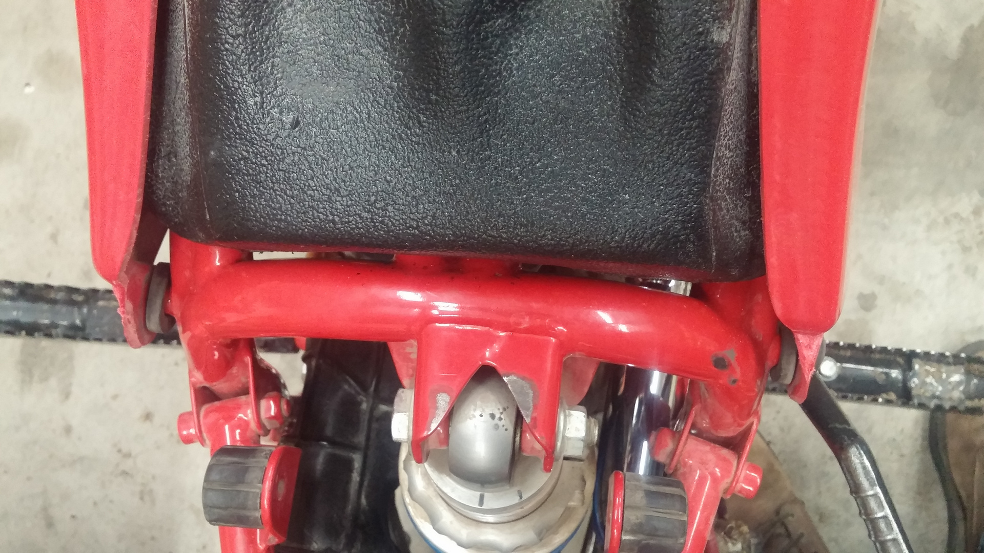

More pics rk88r. Is that a 4.0 IMS? Did you have to make brackets or elongate holes?

I don't remember elongating them so if I did it would have been minimal. I see the bolt in the front is centered front to back. Yeah it's about a year old 4.0 Ims.

Good idea on using a plastic shim to get the seat from rubbing the frame.

I used a miluawkee heat gun on the low setting(750deg.)to reshape some rear fenders I have that were tweaked. It worked very well, just take your time & don't focus the heat in one spot for too long & you'll be fine.

Tbone07  The answer to your original questions are... yes and yes. Someone has used a heat gun to mold a tank to fit and someone has tried a similar situation. The plastic has a strong memory and wants to return to where it was molded originally. You are dealing with the strongest part of the tank, an outside corner. I am no plastics expert. I heated the bottom of an IMS tank to almost liquid form and could not make it change a half an inch even in a flat area much easier than what you are about to attempt. Fenders and the top of a fuel tank are much thinner than the part of the tank you are attempting to modify.
       Please post pictures of your success as you will be the Christopher Columbus of tank melting. Sorry. Just trying to save you some grief and be optimistic at the same time.
