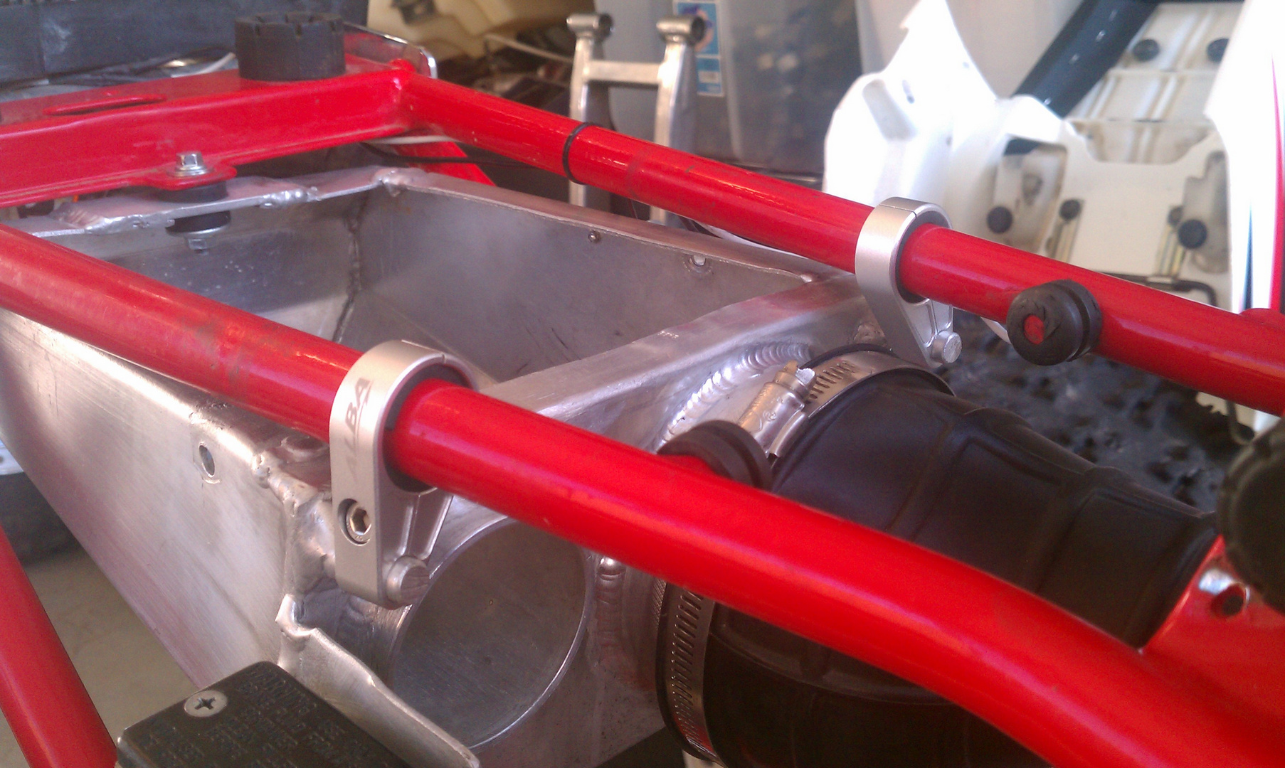

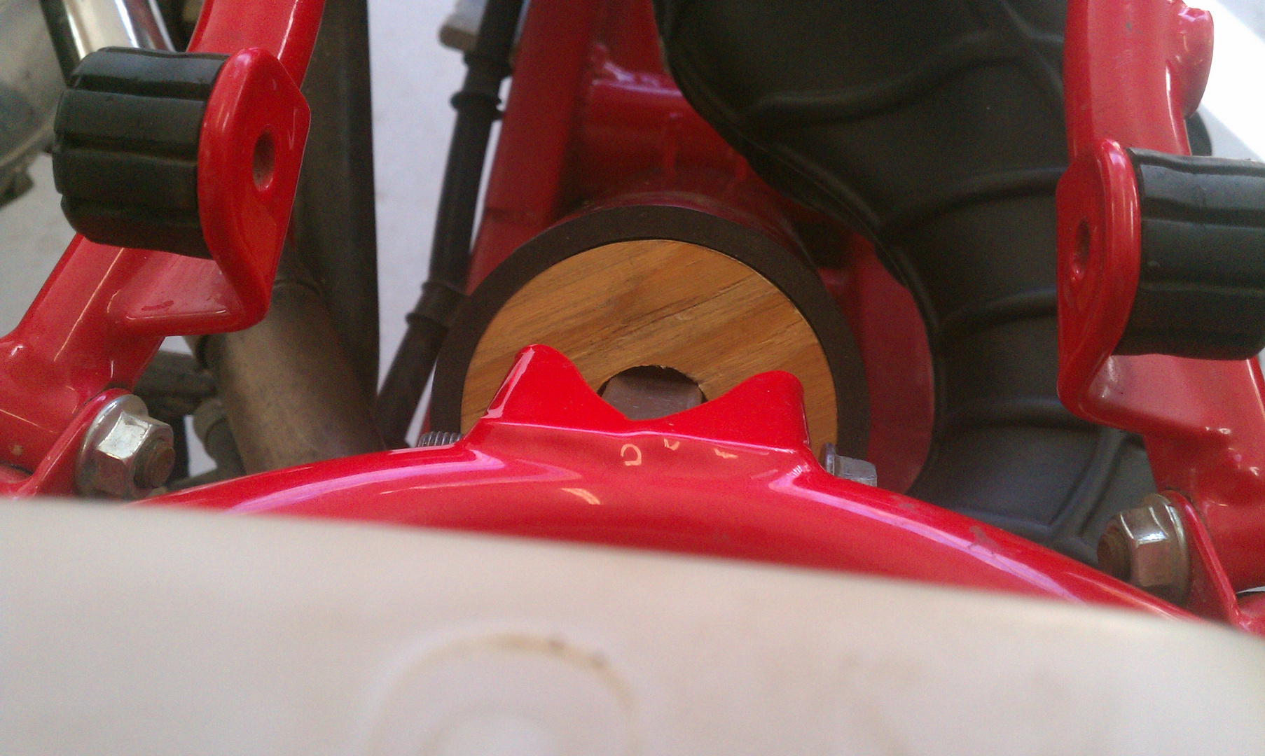

Here's my current intake setup on the Laeger. Pro-Tect airbox (designed for LSR frame), 86 OEM boot, metal pipe, 2" diameter rubber hose to connect metal pipe and carb, sphynx cylinder, vforce, UPP boot, 38mm PWK
You can see how one of the front mounts doesn't line up. I think the LSR subframe is narrower in this section
Plenty of clearance for the rear shock even when I stood on the grab bar (240 lbs)

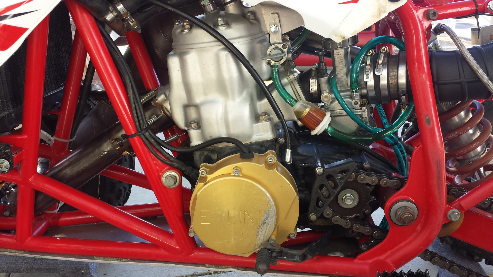

« Reply #20 on: July 21, 2015, 09:05:46 AM »
Here's an older one with no engine installed. I can take a better one tonight after work if you need. Bike is all together now
The extension i'm using is about 2.5" long, i'll take a more accurate measurement after work. There's a lot of combinations of intake boots, carbs, and manifolds. It would be tough to make it a one size fits all application
