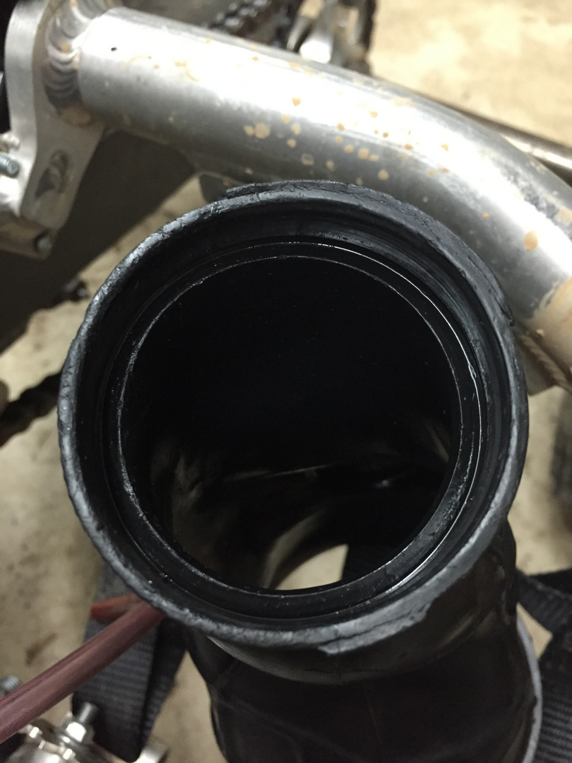

We installed the stock airbox with stock airboot to test again to see if the airboot shrouding was an issue. We fired the engine up and made multiple runs. The engine was still responsive on the bottom up to midrange, but started falling on it face again in the mid to upper rpms. The step in the factory airboot does in fact cause an airflow issue with the scoop in the bell housing. The scoop is critical to design of the carb.

With the 2 separate issues going on with the carb, I don't think we would have ever resolved them without making the drive out to APT. Too many variables. Due to the step in the factory airboot, it WILL CAUSE PROBLEMS WITH THIS CARB. This has to be addressed if you want full rpm range out of your carb. This is not a carb problem, this is a intake boot problem. This problem was hard to diagnose as well because almost no other intake boots have this step in the boot, except for the Honda 450R (not sure about which years). The permanent remedy for this issue will be to purchase: one for Troy Robl's need intake boot and airbox designs, LED's airbox eliminator setup, any other airbox eliminator setup, or fuel customs inc intake boot and airfillter combos.

What is this step in the factory air boot? Do you have any pics?

« Reply #5 on: August 03, 2015, 11:06:17 AM »
Quote from: Pumashine;56758

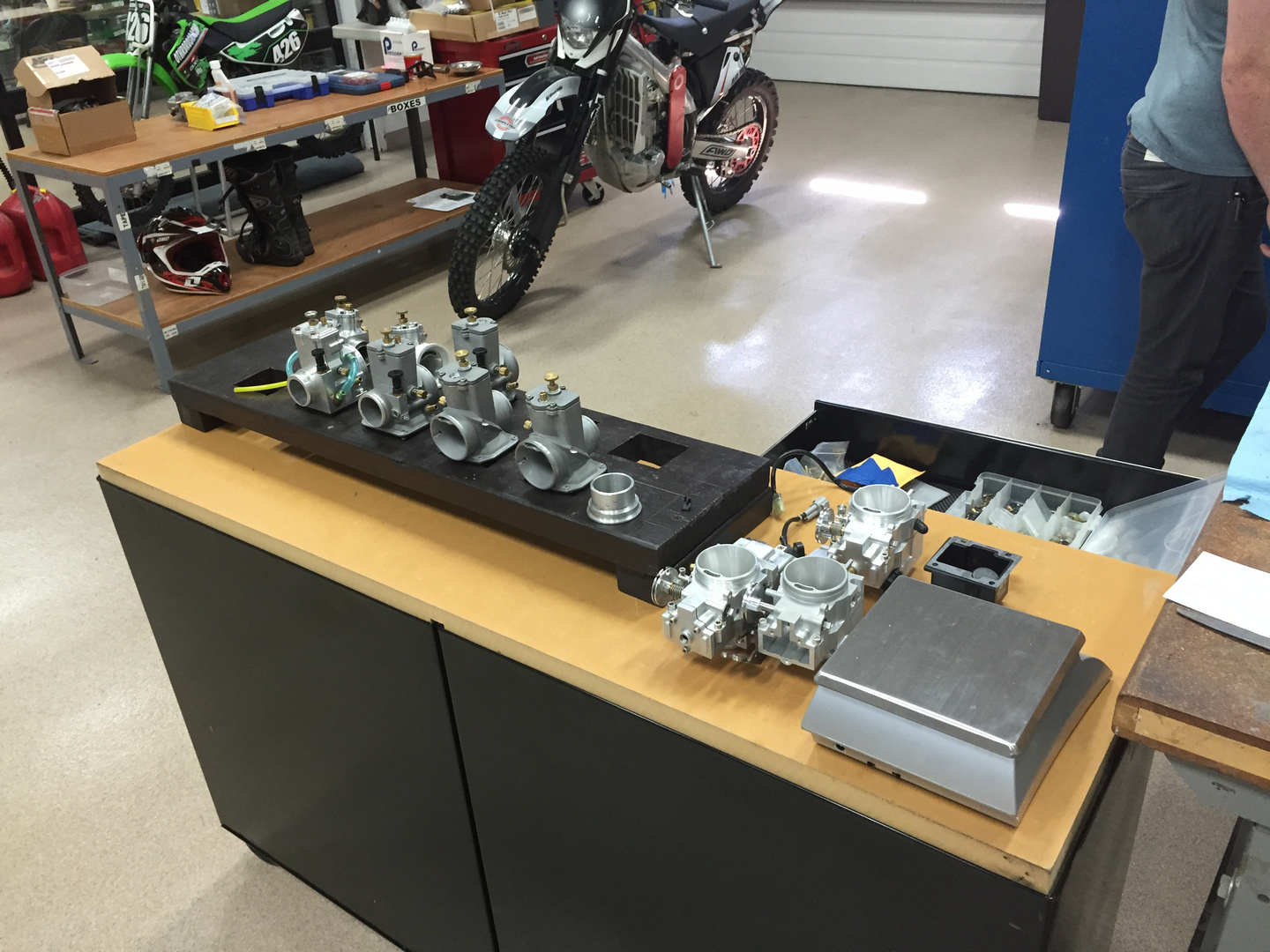

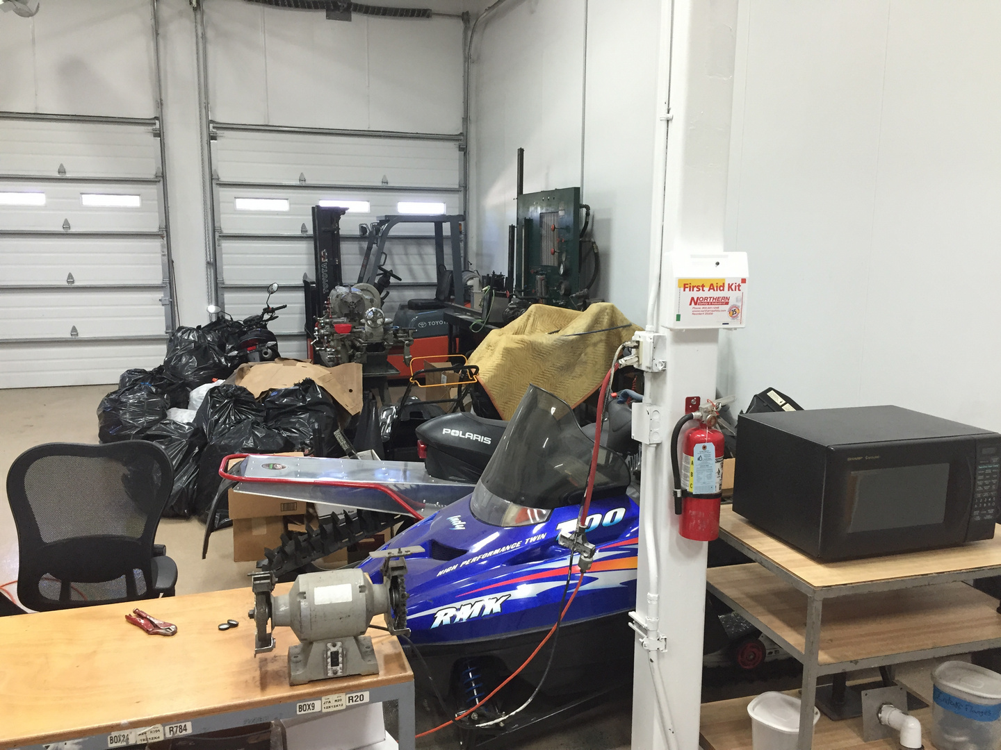

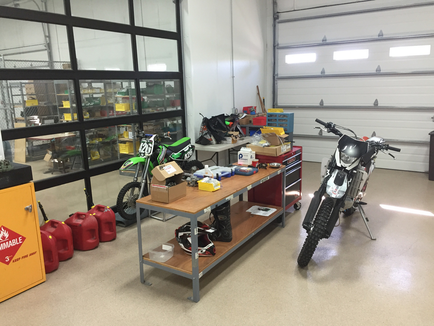

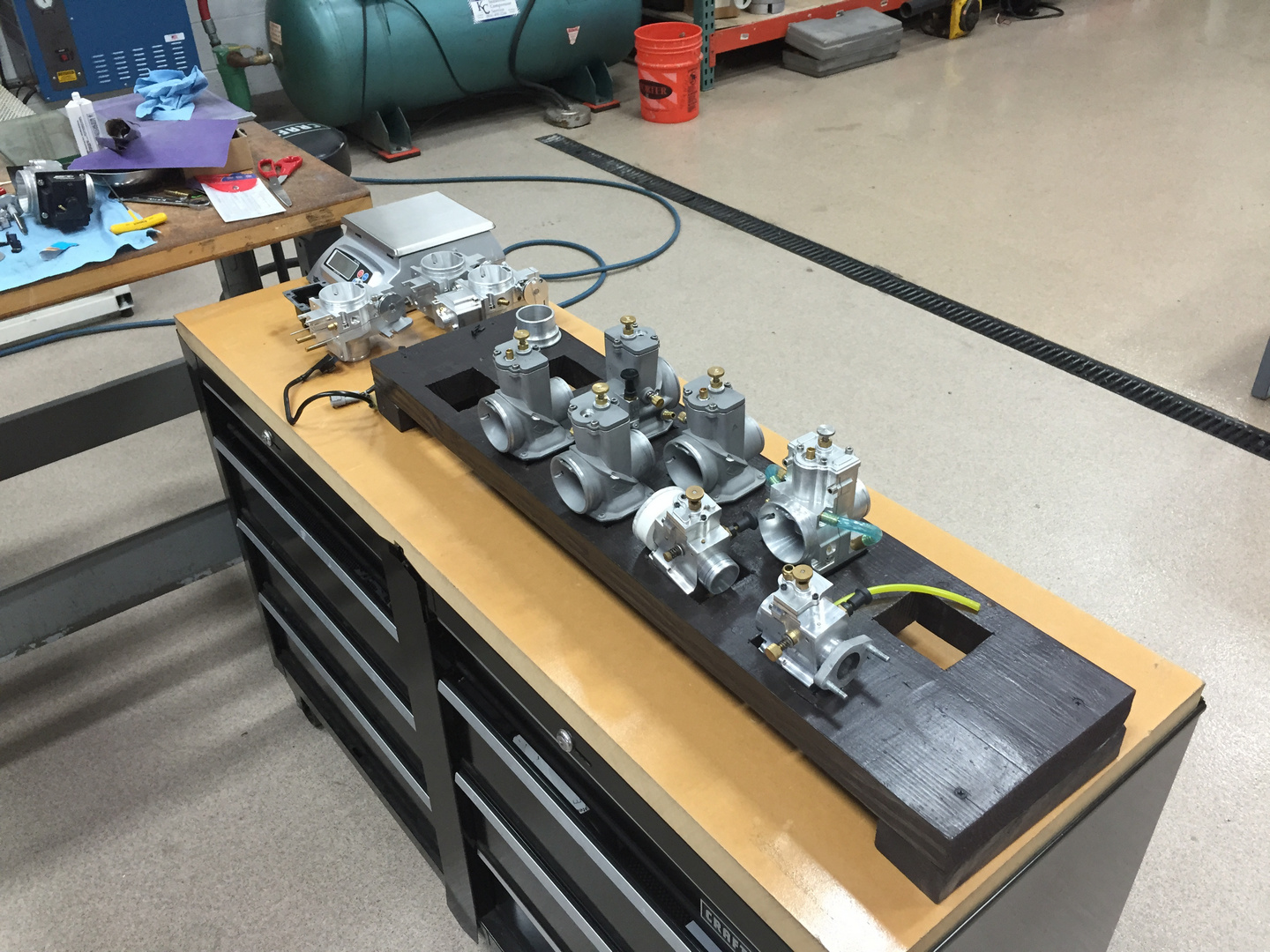

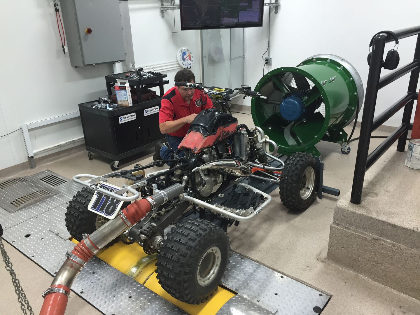

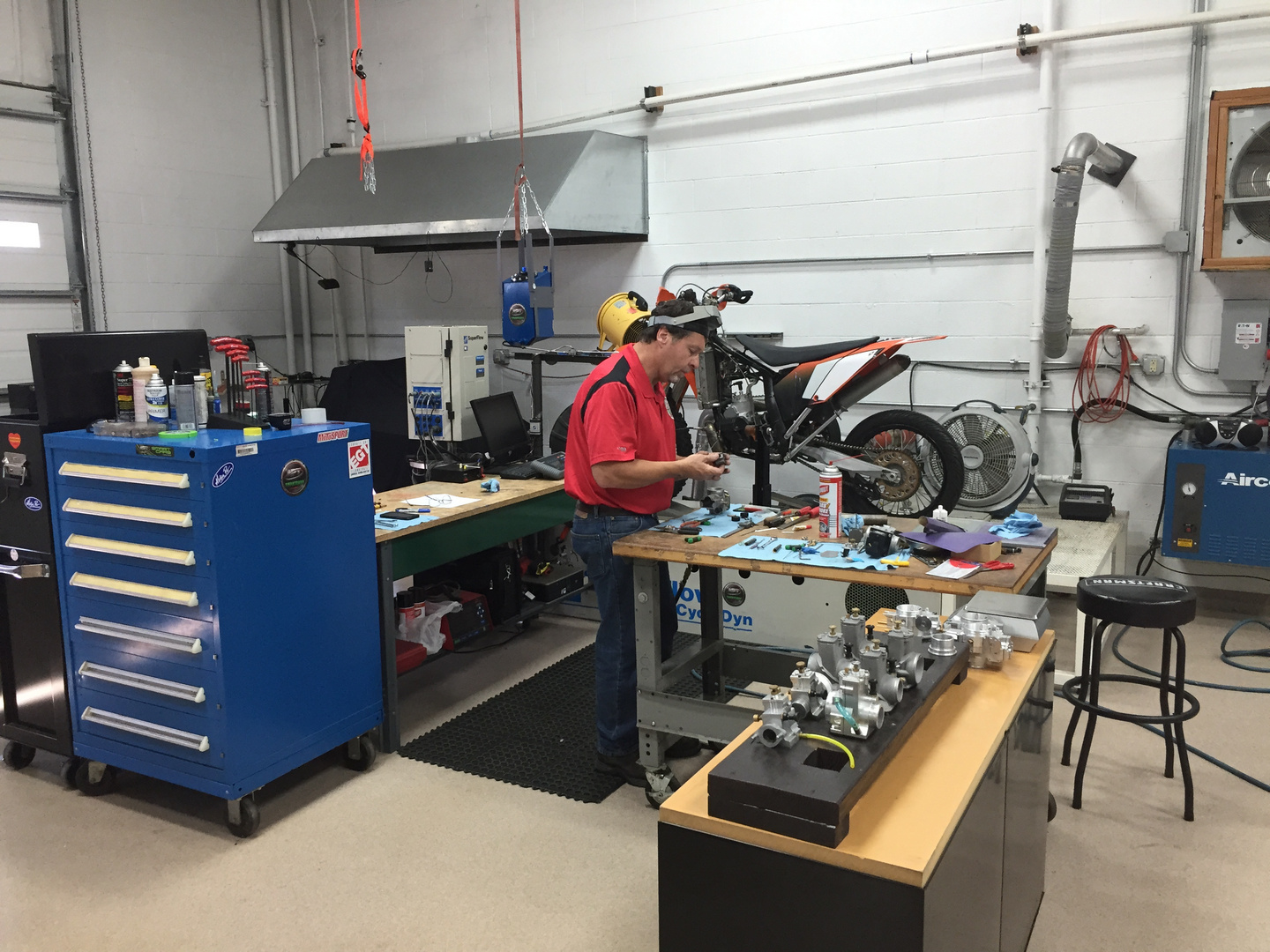

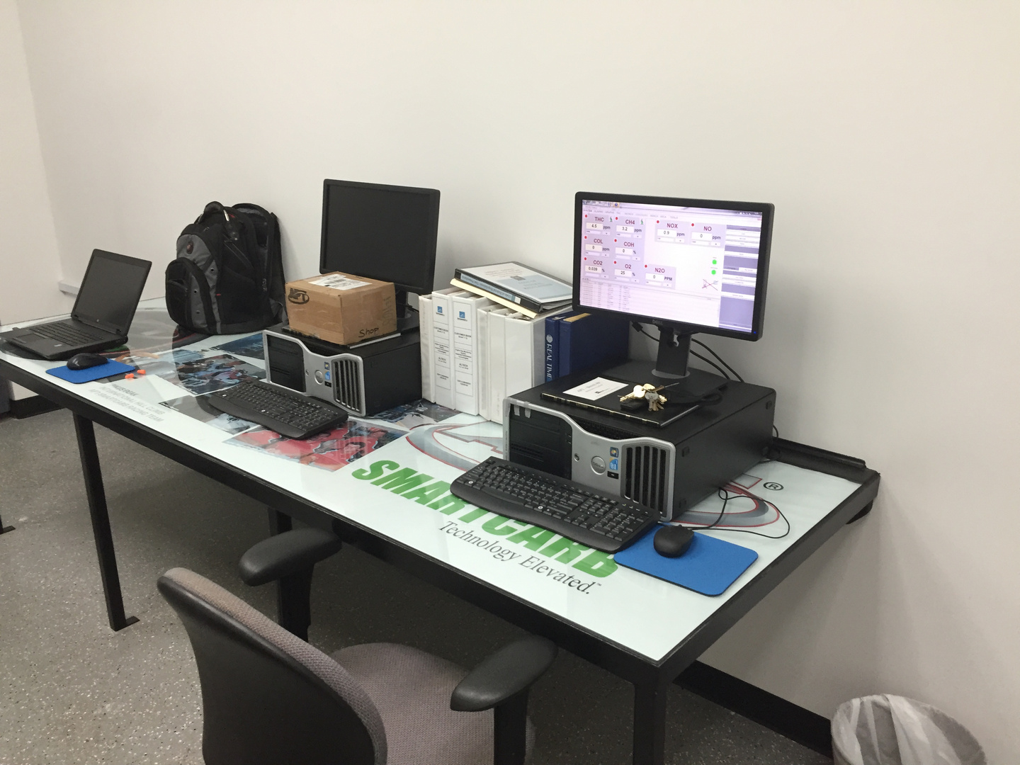

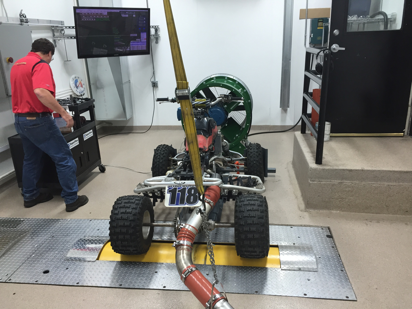

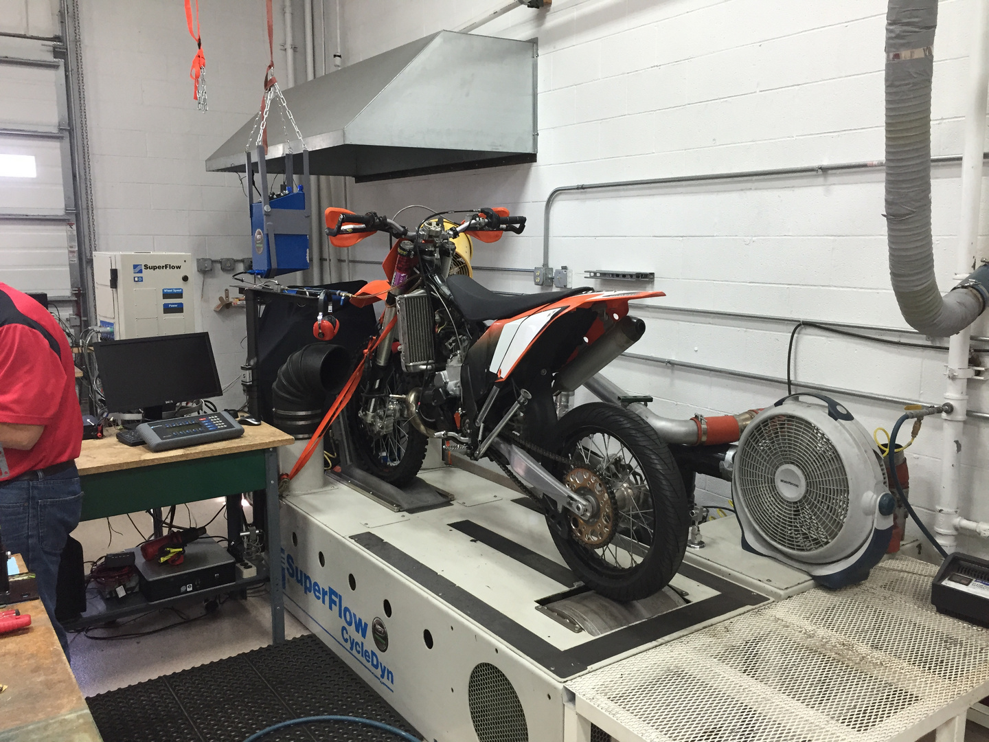

Here are some pics of the R & D facility that Corey let me take.
My trip to APT (Home of the SmartCarb)
« Reply #7 on: August 03, 2015, 11:12:14 AM »
« Reply #8 on: August 03, 2015, 11:13:37 AM »
