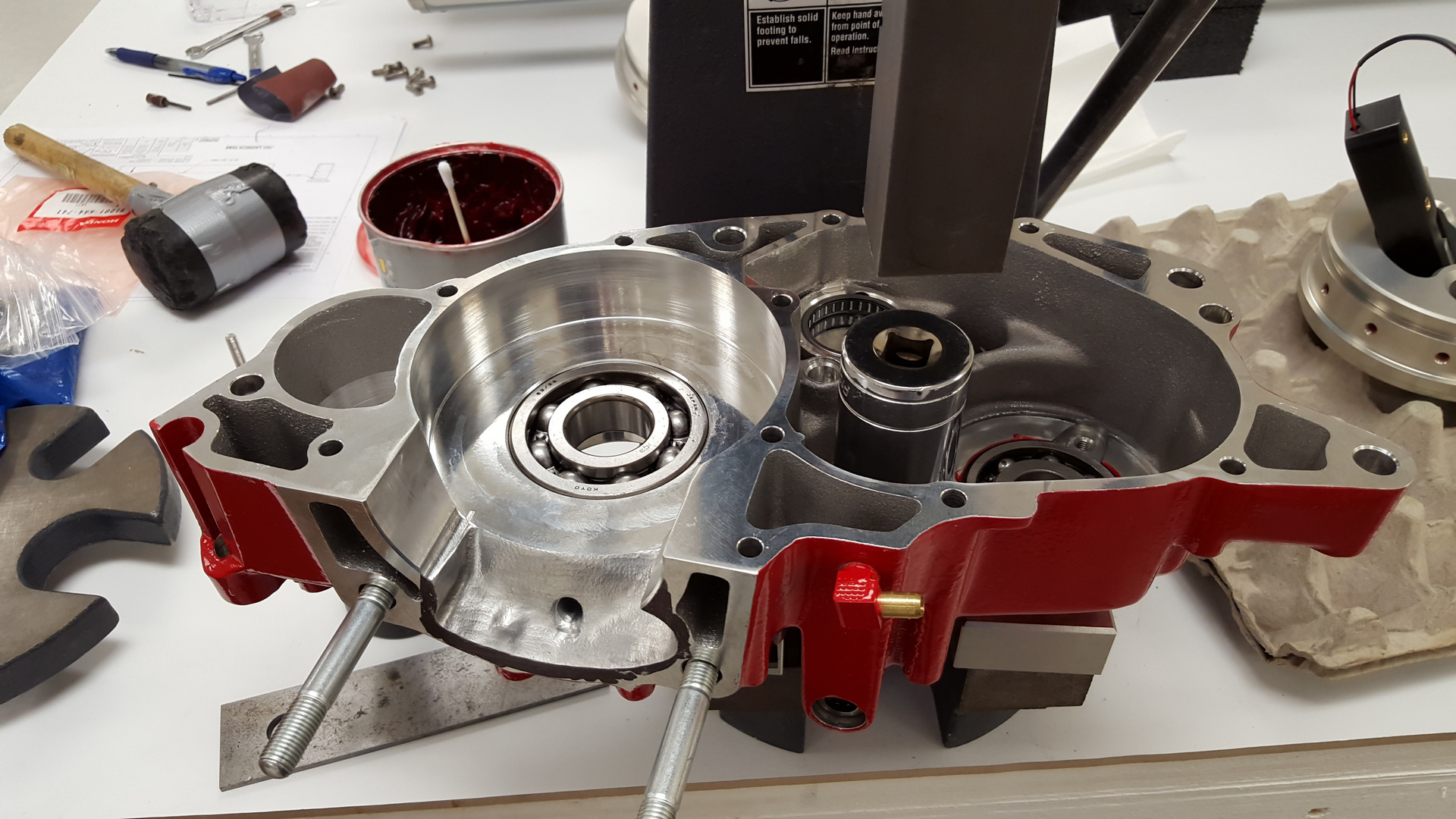

Ok, so i brought the stator side case in to work to press the tranny bearings in as it wasn't happening with limited tools at home. Even though I froze the bearings and heated the cases, they still were to tight for my comfort on not getting them stuck halfway or something (guess the new esr cases are goodntight?!). It worked for the crank bearing but not the others. Anyways, it worked much easier with a press and heat gun:
Question to the experienced: when i get ready to pull the cases together, being as i have a hot rods crank, should I try to open up the ID on that bearing to accomplish the slip fit like stock? I know this is an often discussed item. I don't have a real hone (which I think would be the best/easiest) but probably could take it to one of the local shops to take a few tenths out.

tenths!? no dont do that lol

Yeah, sorry meant ten-thousandths, bad slang from machinist days:kiwi-fruit:! I've read the interference/press is around 0.0003 which doesn't seem too bad...

Get a tusk crank pulling tool from Rocky Mountain atv makes pulling the hot rods crank easier to pull into bearings.  I put alittle freeze on the main journal area of the crank
