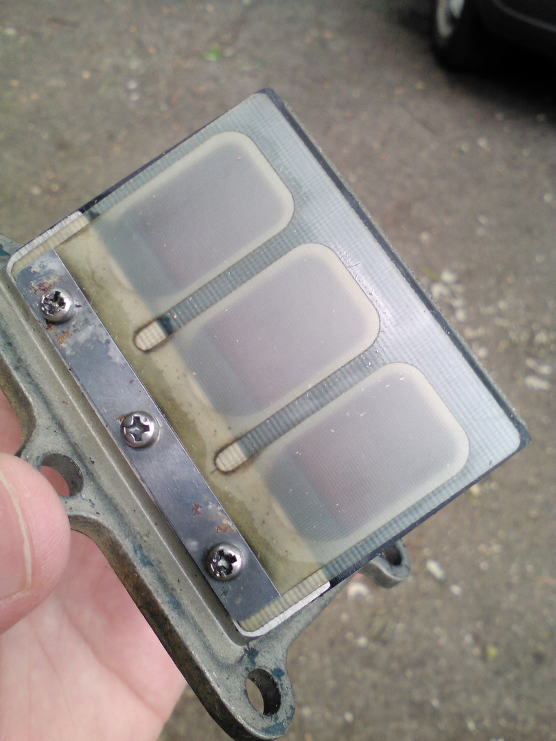

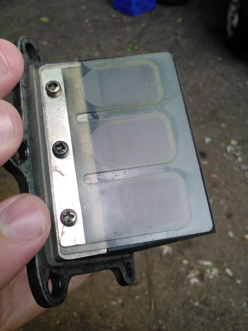

Pulled off the exhaust, carb, and reeds... I will post a pic since I don't know what I'm looking at when I get back from church. Thanks for the responses guys! I don't think it's an issue with the spark plug because it will fire up and idle, and the caliper is not locked up because it rolls just fine in neutral... John, if it's clutch related, would it be plates or basket, or something else?

Tony - The cable is working properly, as I try to release slowly into the gear and as it begins to engage, it bogs down and stalls out. If I pull the clutch cable, it will go back to idling, but will bog a little bit when i give it gas. Then after a while, it clears up again, but will do the same thing when I try to put it in gear. When I fire it up, I can give her gas and it revs just fine... Here's a pic of the reeds...
