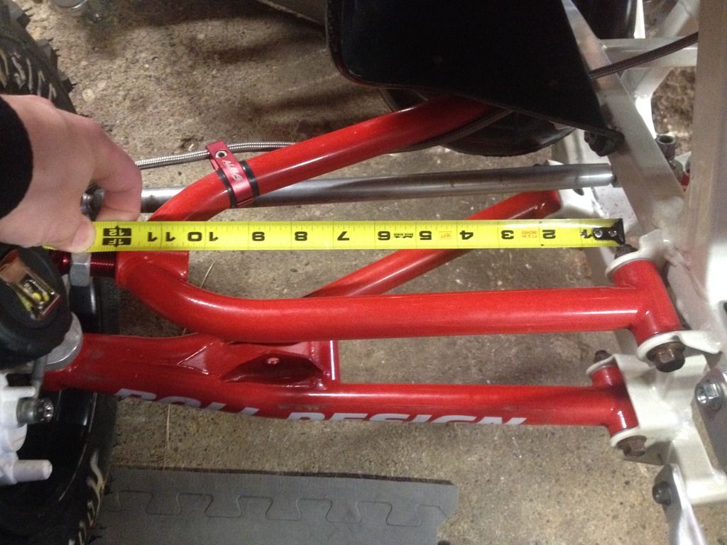

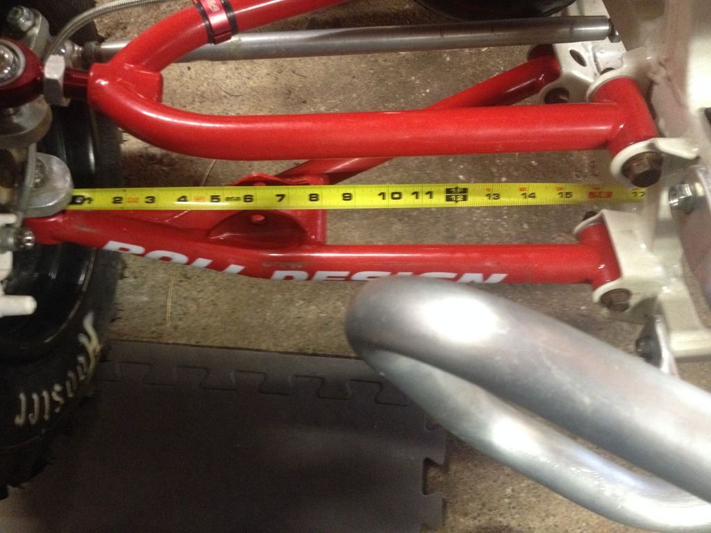

If someone could measure their +3's uppers the way I did so I can compare that would be sweet!

Quote from: Allison#51;59724
Upper is roughly 12" from center of the front bolt to the end
Lower is roughly 16" from center of the bolt too the edge of the spherical bearing cup. And the tie rods are pretty close to equal lengths.
In the above pic are the heims set for 0deg camber? If so then there's plenty of meat to bring it in to a negative camber. Are you trying to bring the top of the tire in or out?
I'll measure mine when I get home after work. I have similar issues with Roll front end setup

Quote from: dem3500;59819
Yes with the heims set there it's at 0' camber at 7 1/2" ride height. I had negative camber in it before. By backing it out to 0' I was able to improve the Bumpsteer slightly.

I got roughly the same measurements on a set of +3 Roll Lobo II arms
