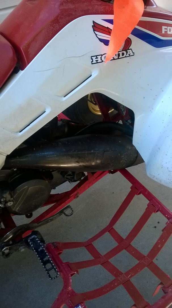

The pipe is a shiny silver one;)
It's a "Paul Turner Racing TRX Pipe" and in reality is not shiny at all. I know that it is a two part pipe (not including the silencer) and that at the joint of the two parts the o-ring is deteriorated, because my right leg has a moderate amount of oil on it after i ride. It might also be that I only have 1 of the 3 springs that should be there compressing the joint any more; or possibly its a combination of the o-ring or the missing springs to hold it together.
Summary of potential problem at pipe joint:
       -Bad O-ring
       -1/3 springs
       -Both
Thank you for your comments about the cool header. I am more familiar with 4-strokes so my first thought was a high compression piston, but am now looking at cool headers.

I'm not an expert by any means but the first thing I would address would be the exhaust just because it's the easiest.  If it has a spot for 3 springs, 1 spring won't cut it IMO.  Measure the spring u got and buy two more or measure the distance between the two hooks and minus 5mm.  Use some rtv sealant when u put it together and the spooge will stay off you leg. 20 bucks will save many a pair of jeans lol.  Good luck with your quad and welcome to the site.

Also your pipe is a high Rev pipe.  If your porting is geared toward the pipe there will not be much "bottom end" left for ya, just saying.  You can't have both on a stock cylinder unfortunately.  If u want both you gotta go bigger 💸💸

Looks like he's got the "trx race" pipe not the hi-rev.
Offline StrokedAZ
High Compression Piston
« Reply #13 on: October 27, 2015, 05:18:46 AM »
Quote from: broken1;60421
You are correct, I misread.  Is the race pipe more of a mx/midrange pipe then?

Ya the trx race is a mid range pipe. Never tried one out but I have a PT hi-rev, it's a good dune pipe but would suck for trails or woods.... New-To-This what carb is on your R?  It looks nice by the way.
