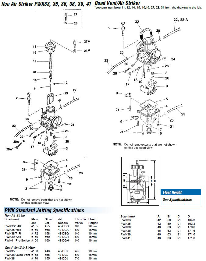

On a PWK, is there the said "starter jet in most float bowls"?

Quote from: havinnoj;61149
On the PWK style of carb the choke jet is a brass jet that is pressed into the upper carb body on the spigot side of the carb.  The choke jet is about 5 mm in diameter and hangs down 22mm below the gasket surface from the upper carb body into the float bowl.  The fuel flow flows through a .033" hole inside of this brass press-in jet.  I usually enlarge this hole to .035" to .040" for gas and .046" to .050" for alcohol depending upon the temperature.
CAUTION:
It does not take much of an increase in diameter to make a difference.

Does a standard 36mm pj have this starter jet?? or is this only a feature in a pwk?

The jet's flow area may be reduced due to a layer of varnish inside the jet or the jet may have some debris reducing the flow when the enrichening circuit is activated.
Offline Jerry Hall
Lean starting when cold??
« Reply #12 on: November 20, 2015, 09:14:05 PM »
I think that the PJ carb's enrichening circuit has a very small metering rod that is part of the enrichening plunger.  I believe Keihin over-engineers some things on many of their carbs, omits some features that other carbs have so that the whole carb has to be replaced when some circuits ware out and I think that some features are just stupid.
