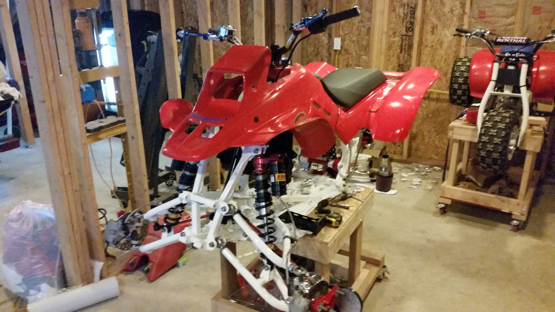

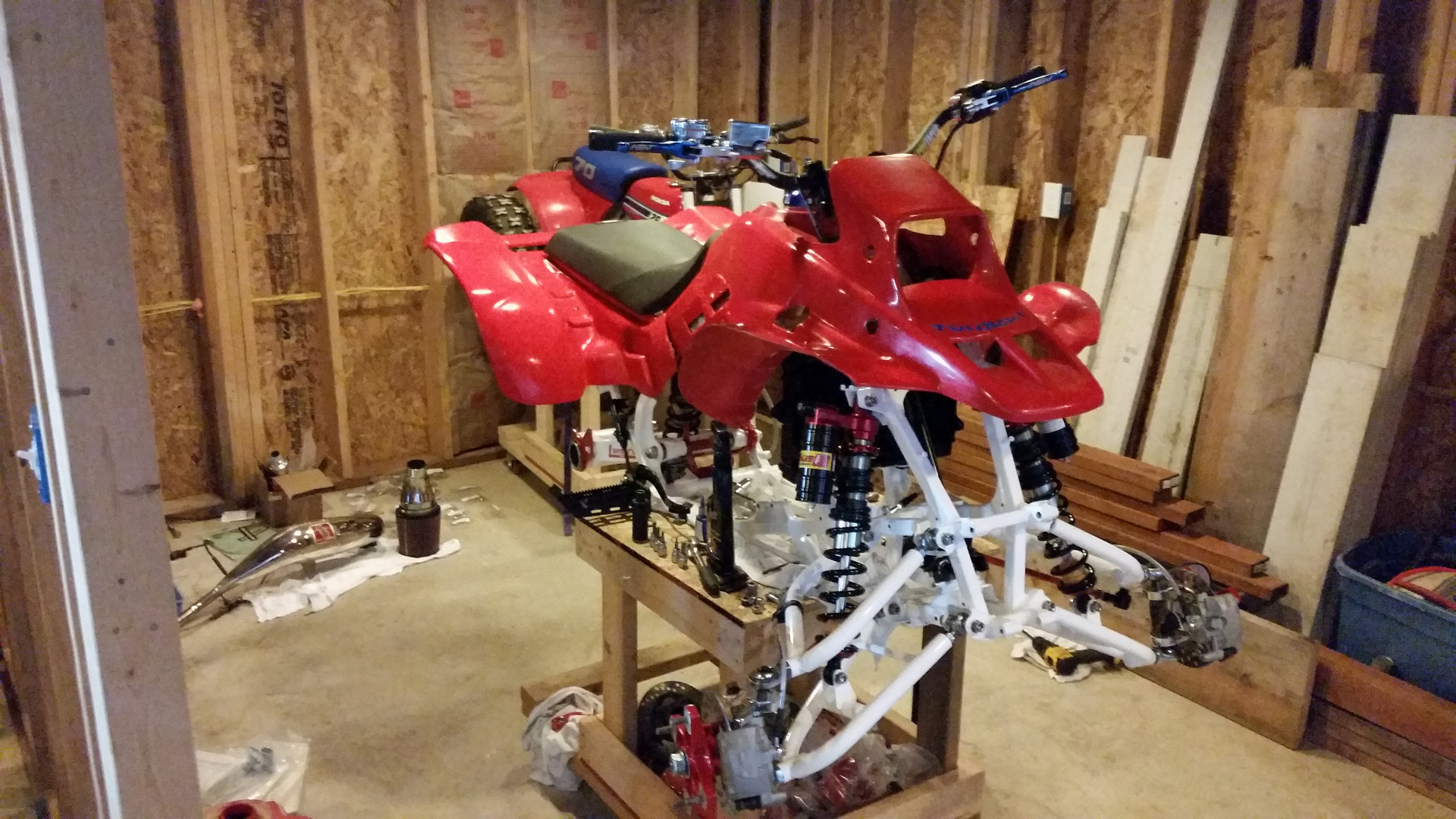

Offline 250rmanpuma
Plastics
« Reply #12 on: November 29, 2015, 04:56:46 PM »
Couldn't wait to see it with some plastics so I test fitted them.
Offline Robsessed86
Project "Retro with modern twist"
« Reply #13 on: November 29, 2015, 09:40:27 PM »
Going to be a real nice quad. Where did you find that extremely rare 88 fullbore front?
Offline 250rmanpuma
« Reply #14 on: November 29, 2015, 09:59:23 PM »
Got it from a member on the 250r.net forum about a year ago.    I definitely like them.  They have scuffs on them and not really any scratches mainly scuffs. Im trying to figure out hoe to polish them out without sanding them.  I have been using rubbing compound and polishing compound but not really a huge difference yet.
